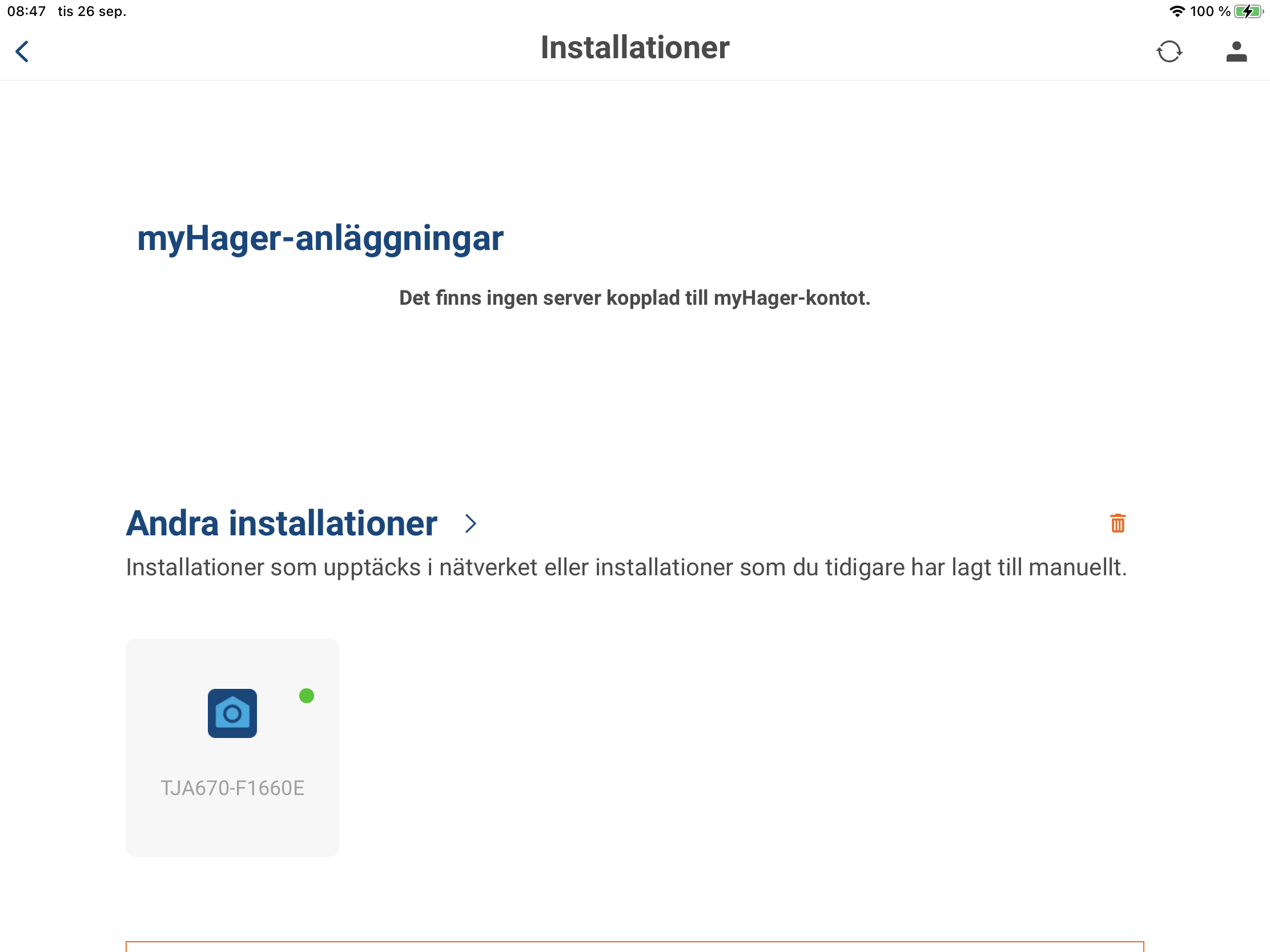

Download and install the Hager Pilot app for your device (Ipad/Android/PC etc)
(Install on your device, not to the Homey app).

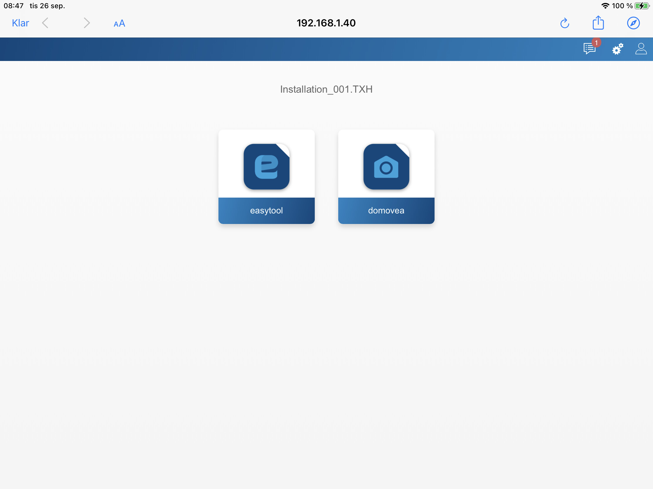

Open Hager Pilot and connect to your system:
(Default login is admin and password 1234 to domovea.)
Click on Domovea:
