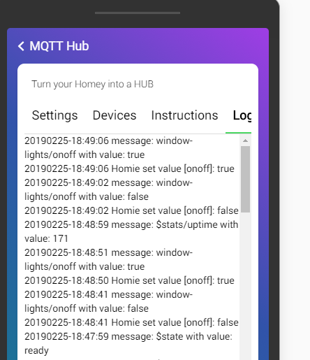

hmm… i wonder why… even though MQTT see this
20190225-16:05:16 message: porch-light/onoff with value: 0
the light doesnt turn or off in Homey

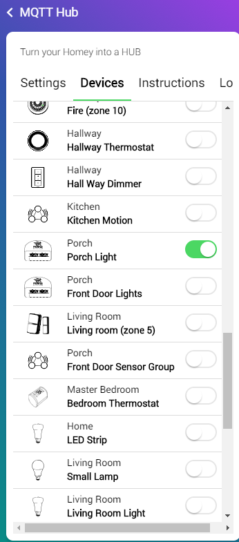

For simplicity - I have only two devices set up

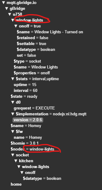

All the gBridge branch is created correctly (as a renamed homie format). I have setup a couple of devices in gBridge that control Hue lights via Homey. Here’s an example topic as configured in gBridge and an expansion of the gBridge topic. It’s a Kitchen Table light named kitchen-table in MQTT.
It all works OK and is synchronised bidirectionally.

I noticed that you wrote “window-light” in one post and “window-lights” in another. Check which is correct.

So I reinstalled just using the appstore versions of MQTT Client and MQTT Hub Beta
this is the screen from MQTT Explorer
this shows it leaving homey as i toggle on and off the light from homey
this shows it coming back if toggle on off from Google Home
