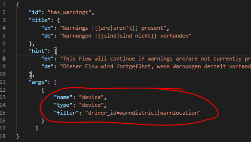

Condition definition (.homeycompose) with device argument:
Handler in app.js (onInit()):
It’s reading the device capability with calling the device function (args.device.)
So you have one handler for all devices and propagate the call to the current device.
