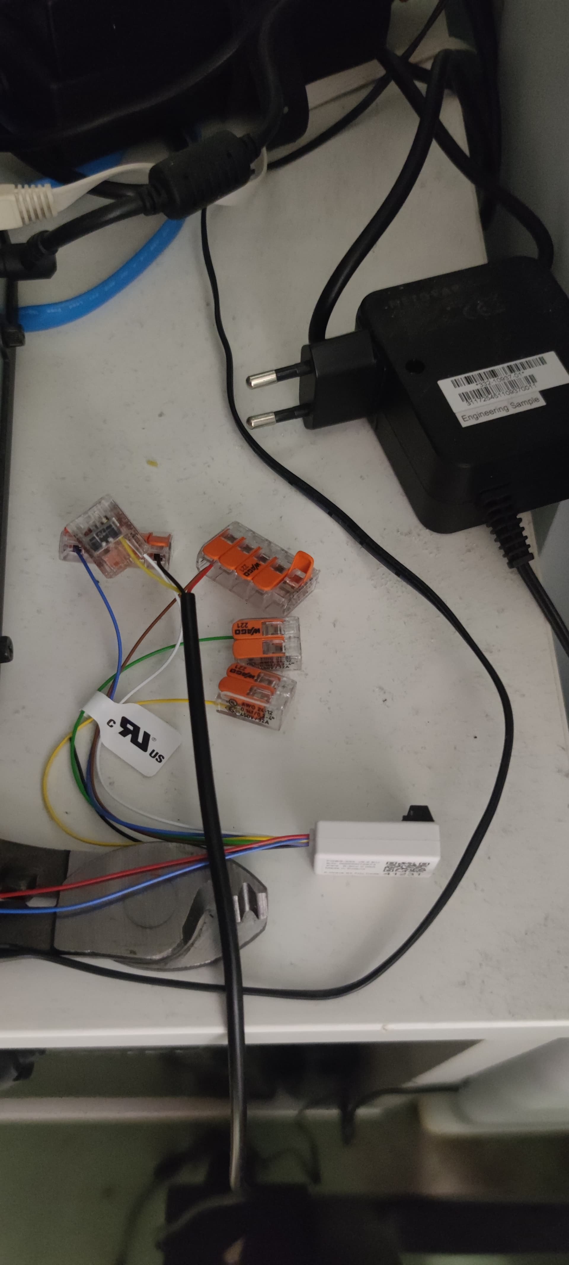

Are the sensors connected correctly? Can you post a screenshot?
IMG_20230828_174839
Here is a pictur of it , but perhaps hard to see
Red on sensor is power and connected to implant brown
Yellow on the sensor is data connected to white implant
Ground black sensor is connected to blue implant
