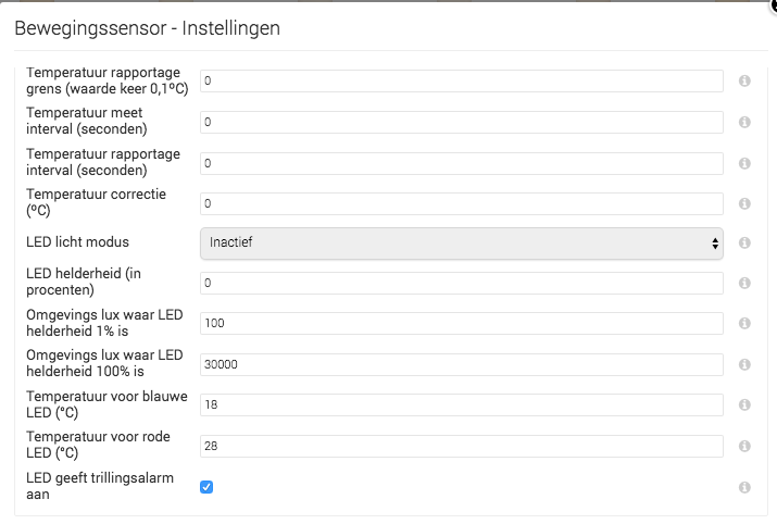

@danone, why do it with the raw parameters, when it’s available in a dropdown menu?
I’ve changed that setting to inactive, but the motion sensor keeps blinking green when motion is detected.
Sure it was saved correctly to the device then?
With battery-powered devices I always wake it up first before pushing the Save-button so you’re sure it gets saved right away.
Works, too. Doesn’t it? :wink:
Yes @Coolrunnings press three times the button until you have the blue LED on then hit save.
True is does also work, but when using the RAW parameters, the corresponding settings (drop down field) is not updated / showing the actual situation.
@Coolrunnings like @danone mentioned, the motion sensor is a ‘sleeping’ device and is only able to receive a command when awake… so the updated setting will only be updated after the wake-up interval (default several hours), or when the sensor is awake during saving (immediate transmission)…
To recover (if you now press save, Homey will not see a delta in settings) you’ll first need to:
  1. Select another value of the setting (to make sure that there is a delta)
  2. Wake-up the sensor by tripple pressing the B-button
  3. When the LED turns blue, press the save button
  4. Once the LED turns off, select the desired setting (Disabled)
  5. Wake-up the sensor by tripple pressing the B-button
  6. When the LED turns blue, press the save button
Now it should not light up when detecting motion…
