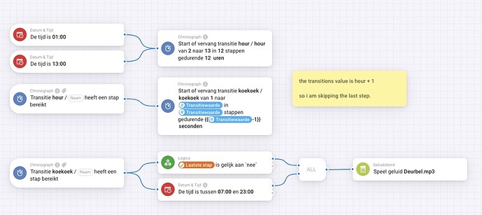

If you don’t want to use homeyscript at all:
It turns out that when you wanr one hour between steps you have to have 13 (!) steps in 12 hours.
