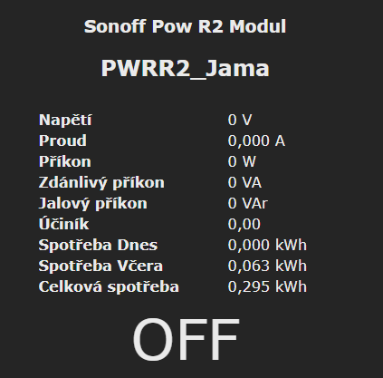

I have SONOFF PWR R2 flash tasmota firmware and set like R2. Info in tasmota is works ok
i add device via MQTT Broker and SONOFF App, device add correctly and report actual power in W, voltage and Current A, all i can see in insight.
I add new device in “Power by the hour” i choose my PWR R2 from list, all ist without error.
But no data
now, i add for test PWR Sonoff via TASMOTA APP (no sonoff) and looks like all working
thx for me.
