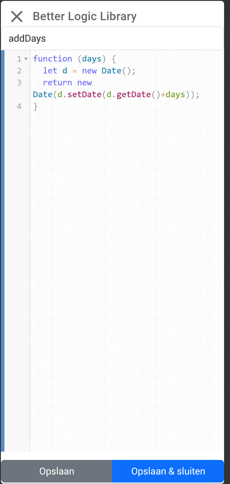

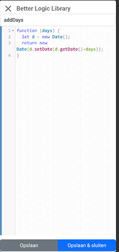

What you also could do, is create a function in the BLL App Settings called f.i. addDays, with this in it’s body:
function (days) {
  let d = new Date();
  return new Date(d.setDate(d.getDate()+days));

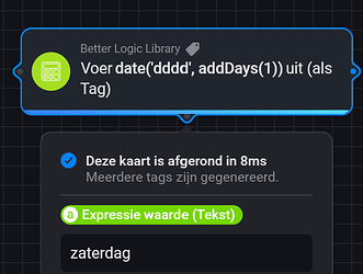

then write this in the Expressioncard:
date('dddd', addDays(1))
Thus, what you have now is:
and
Or, if you want know the day after tomorrow:
