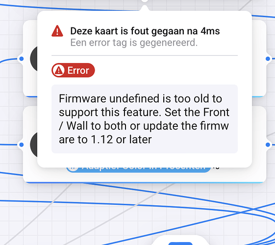

Just my first impressions with 0.7.3 app and latest 1.13.3 firmware (not 2.x firmware!)
  • Buttons no longer update. (error below)
  • Diagnostic log cannot be send. I get an error.
Do I need the latest firmware to use the latest app version? (I would like to stay with 1.13.x)

Whoops; and reverting back to latest stable makes it impossible to edit settings. Give me an error when opening the app setting page. (This screenshot is from app 0.5.10)
Hmm, I tested it with firmware 1.13.3 as I deliberately kept one of my Button + units on that version.
Strange the message is “Firmware undefined…”, which suggests it’s failed to read the version number from the configuration.
Could you try again and then copy the log and paste it into a text file and email it to me.
I think I have worked out the Firmware undefined issue: I think you are running the Flow too soon after the app starts. I have added a delay between the app starting and configuring the Button + modules so that other apps have time to start up when Homey is rebooted, in the hope that any capabilities assigned are ready to go. the delay is between 30 to 60 seconds, so make sure you wait until that has happened before running the Flow.

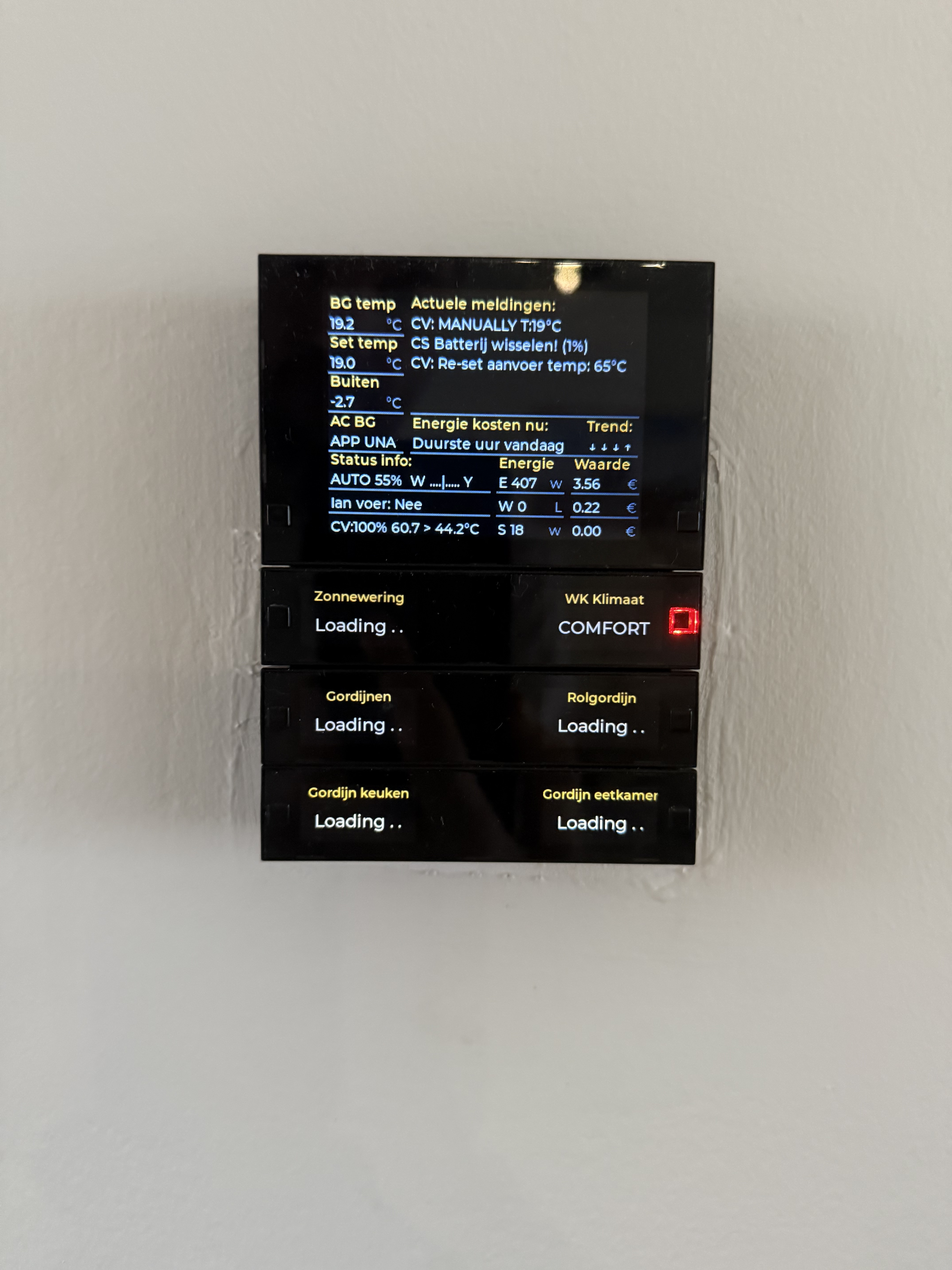

I tried the latest test version this morning. Unfortunately, all the buttons remain ‘empty’
How I configured:
All buttons have an on and off status. However, the text for both is ‘Loading…’ the led color I do use. With flow cards I overwrite the button text. This way they remain flexible and I also see it immediately if something goes wrong. Any idea what to do? I sent a diag log this morning this is working again :+1::+1:
Ps. When reverting back to latest stable everything is working instantly. The latest test version is also not working 30 min after updating or after restarting the app.

My Button+ is totally ‘black’ since 0.7.5 :frowning: Using “Repair”, it quickly flashes the display and the button labels/texts but then black again…
I have published a new test version with fixes for Flow where I had missed the page option.
Unfortunately i have also a black screen even with the latest test firmware… reboot or something doesn’t fix it
I had the same, but changing the broker to another one and back to the original fixed it.

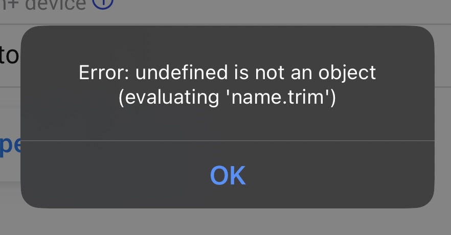

From all my button configurations the name is gone and I can’t add/save a new one which makes it hard to identify when using in flows
I had the same. ‘Solution’ here was:
  1. Power cycle button+
  2. Open web interface of the button+ and downgrade to 1.13.3
  3. After installing the firmware re-apply the config.
