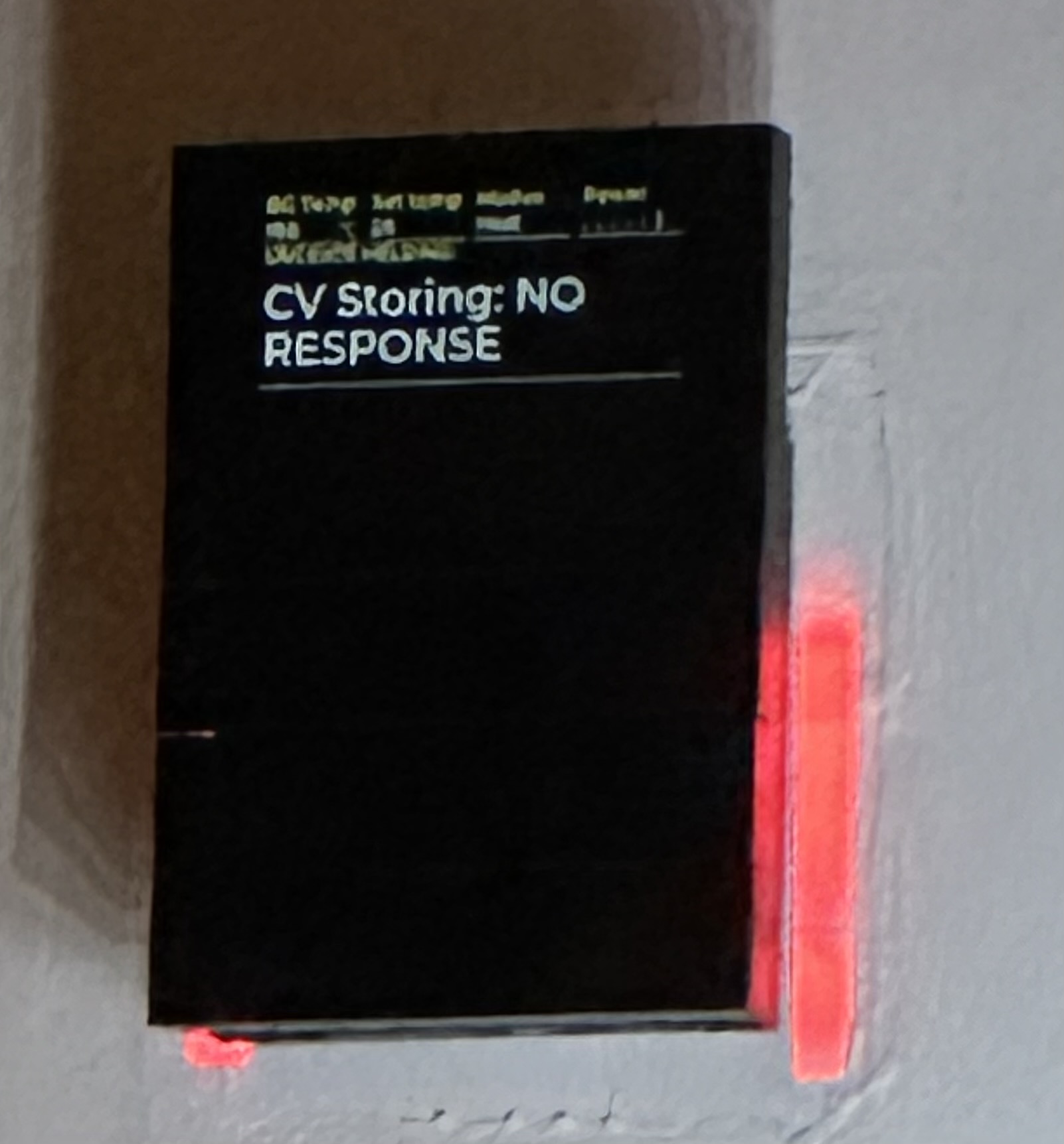

Good morning and sure! sorry my english is so bad. Hopefully the help of Google translate will make it clearer! - I regularly use the option to switch the buttons to a different configuration and then switch status with flows (connector x left on/off and right on/off). example: the buttons represent curtains closed and some other functions. a total of 3x front LED on (green) and 0 times back LED on. With the old app, in the event of a malfunction, I switch the screen to number 2 with a large ‘urgent’ message. the buttons all go to config 5 (black/no text) and on (all LED behind red and LED front off). this works great. with all the newer apps when I do the same thing different things keep happening. For example, with exactly the above, 2 front LEDs remain green (but tekst is gone / black screen on buttons), 3 front LEDs become red(?) and 0 LED at the back turns on. If I switch back to the ‘normal layout with curtain state, things are also missed. I don’t understand this because the buttons are in that case just a device state. If I downgrade to the latest stable app, everything immediately works as expected again. is it described more clearly this way? Maybe that I do something wrong? Otherwise I’ll make a video of it! Thanks again for the great support and great app!

Example of the ‘urgent’ view:
OK, I understand now. This is indeed an issue with the latest versions as I don’t upload the new configuration but just change the MQTT values. Currently, there is not an option to set the new front and back colours this way. I have created a pull request for Robin and I am waiting for him to merge or reject it as he sees fit. If he accepts it then the issue will be fixed in the next firmware update. If he rejects it then I will need to revert to uploading the new configuration again, but that method is slower and will eventually wear out the persistent storage on the Button plus.
