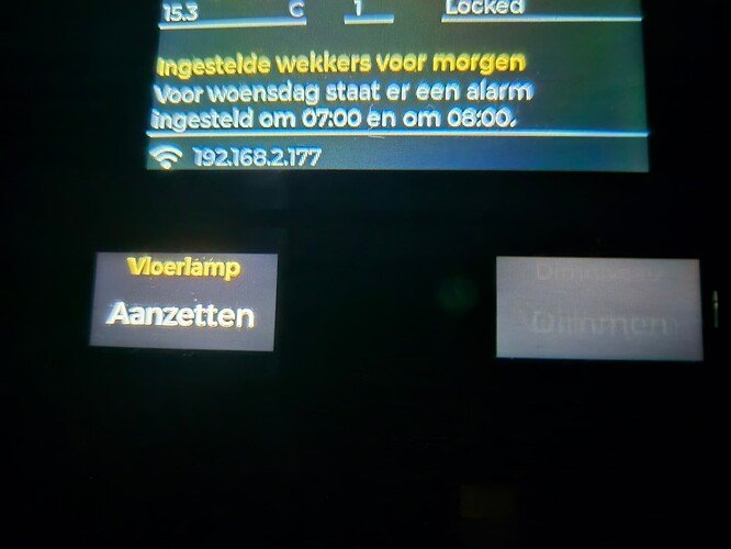

@Adrian_Rockall , the right button problem is not that it’s not being updated, but the contrast of the text is realy low and only readable if you look realy closeby at it in a dark environment.
It is not affected by changing the dimvalue.
That’s strange. I have no control over that as I can only set the brightness per bar.
I will pass it on to Ronald to see if he has any thoughts.
Ronald has not seen anything like that before either. He suggests requesting a replacement as it looks like a defective display. Button +
I doubt it is hardware, when skipping to the next page (fw 2.0/7.10) the left button has the same behaviour (some kind of grayed out) and when skipping back it is normal again. When deploying my older configuration both bar-labels/info is showing like it should. I think deploying the configuration again is triggering something, because it showed after this step was performed. And there was a similar situation reported by another homey user, also on fw. 2.0/7.10.
I am going to create a new configuration and will make a picture of the first situation and than what is shown after deploying the configuration again.
Thanks for exploring with me, it’s quite uncatchable what is causing this.

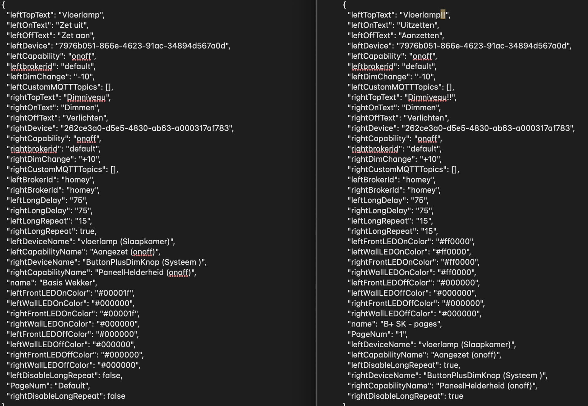

With firmware 2.0 my initial display/button configs are showing the text normal. When choosing a item made with firmware 2 active i get the ‘not visible buttons’. One thing which seemed to have some impact was that i also had a button with device ‘none’. For testing puposes i just added a testdevice and that somewhat seems to make thigs better. Where at first sometimes the left button also greyed out, now only the right button seems te be doing that.
I looked at the differences between an old item, build in previous firmwares/app versions (left side) and a similar new configuration (right side). In the new configuration, i didn’t change anything in the colorsettings, so they differ.
Another thing i noticed was in the old item: “rightLongRepeat”: true, and in the new item: “rightLongRepeat”: “15”,. Not sure if that has any impact.
Hope this helps. And i doublechecked. The right button can work just fine in my older configurations (using fw2), so hardware looks to be fine.
When you have the dimmed display, could you got to the Button + web page and export the configuration and email to me so I can see what it has received.
I’ve sent two different configurations to you.
