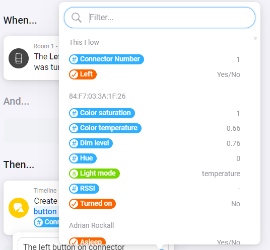

I have 3 bars. My display is in 1. Could it be that connector 1 is not registered?
(Sorry for the dutch screenshot have changed the homey to english just now)
The display buttons are named differently in the list:
But you can use the local tag:
Ah thanks! Found.
