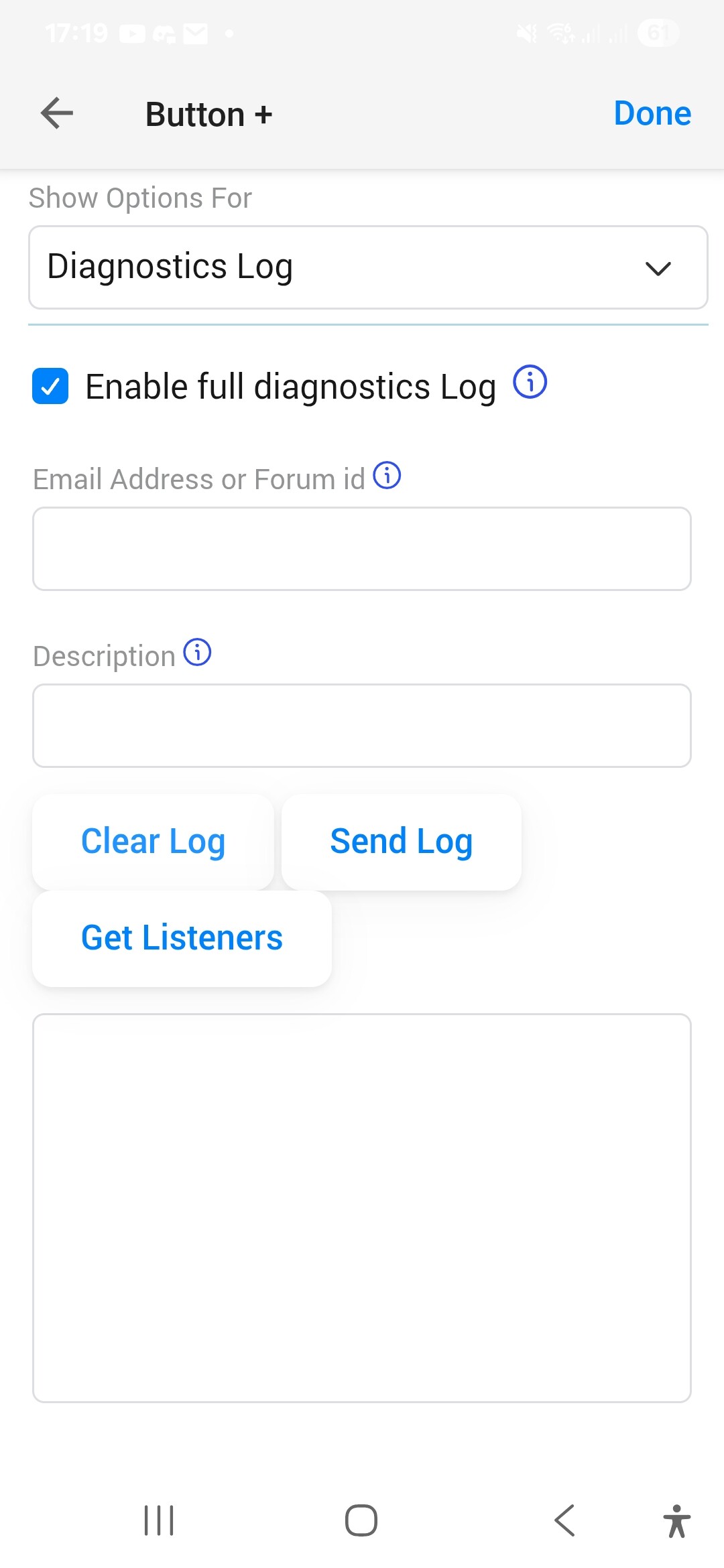

Could you open the app settings page and select the Diagnostics Log option, then enable the full log and wait to see if any errors are reported. If so, send the log so I can investigate. Also try restarting the app and then send the log again.
Solved. I restored a backup and then reloaded the configuration from Homey.
It is not yet clear what caused the problem. Perhaps the submitted log files will provide more information.
