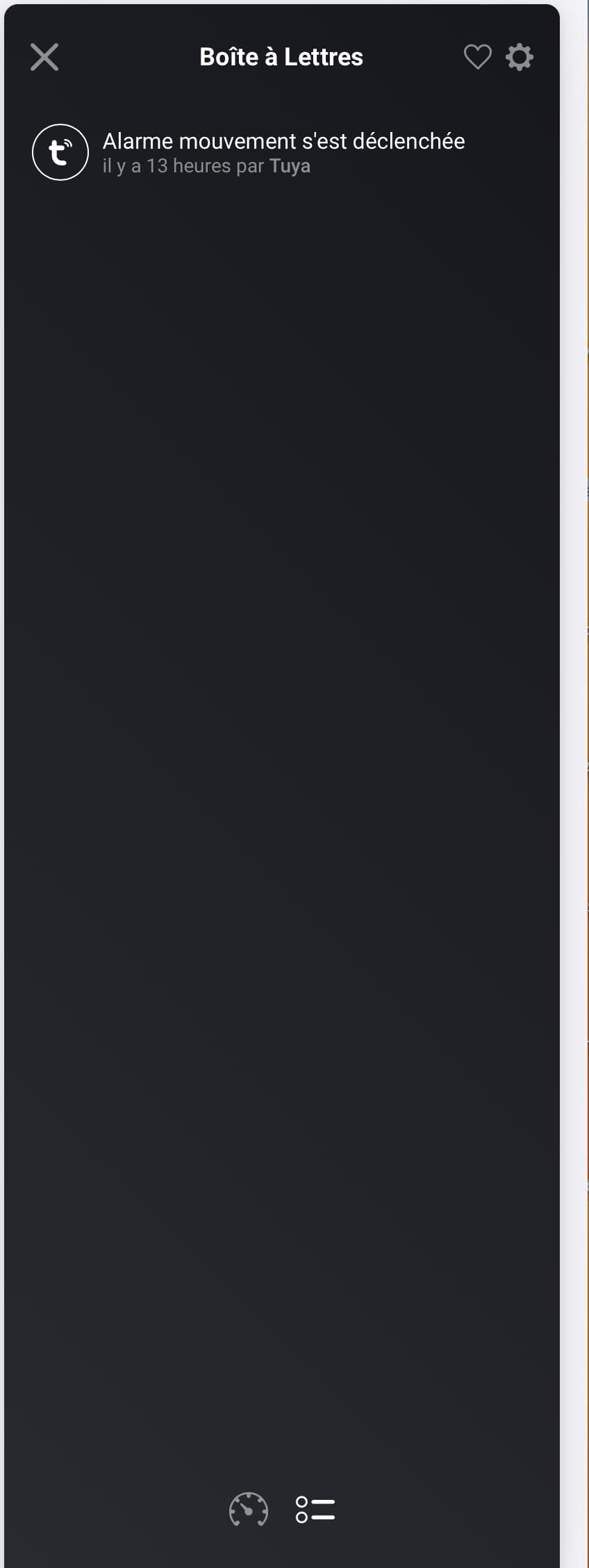

Tuya Motion detection stay always in “detection” , even 13 Hours after the first one (when i add the device)
Reported already 6w ago, but marked as solved without a fix:
