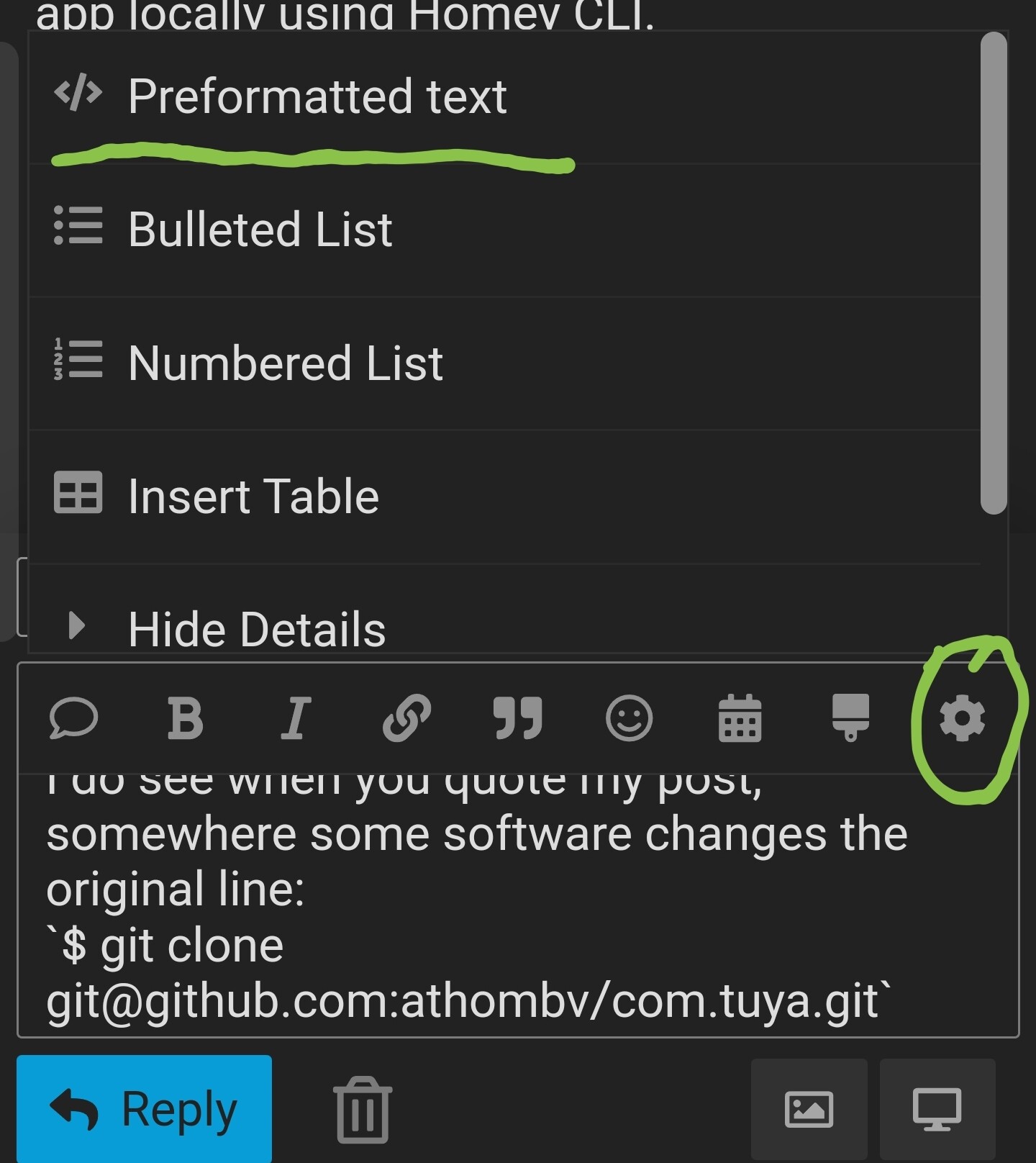

I do see when you quote my post, somewhere some software changes the original line:
$ git clone git@github.com:athombv/com.tuya.git
into this line with the made up email link. This is unusable and does NOT work
$ git clone [git@github.com:athombv/com.tuya.git](mailto:git@github.com:athombv/com.tuya.git)
This wouldn’t happen if you put code between a set of ``` signs
It’s also insertable with this button:
Hit the sprocket when it’s not visible:
