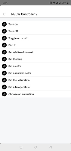

I don’t have specific output brightness?
Maybe because you’re using RGBW controller 2
And my flows are based on RGBW Controller 1 ?!
You can only ask Athom to implement the specific brightness for controller 2 as well.
I wasn’t aware that there are differences between controllers 1 and 2.
