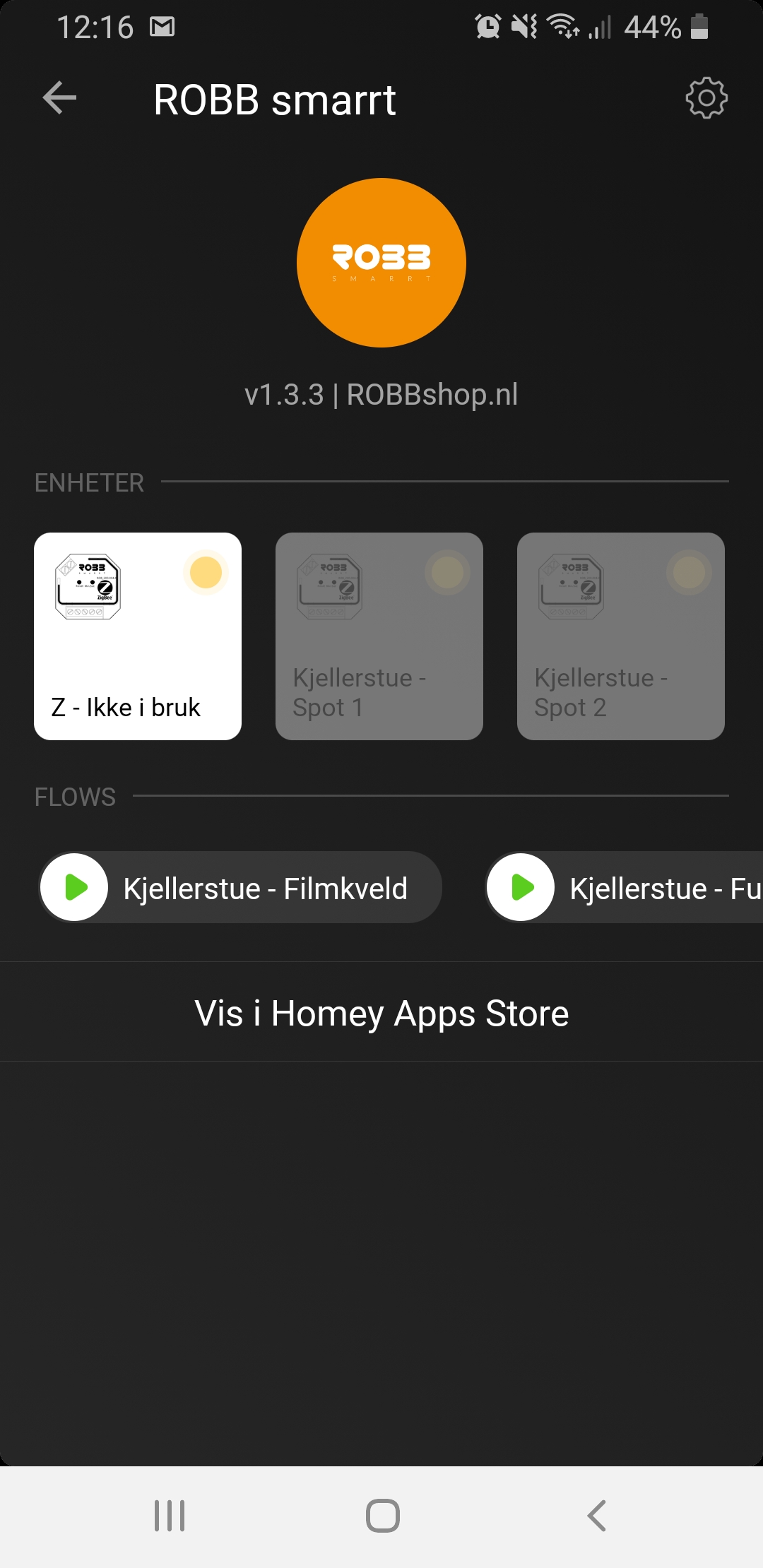

Thanks. For some reason, I only see the Zigbee in-wall dimmer modules reporting in. Can you restart the ROBB smarrt app and share a screenshot of the device details in the Homey app?
Hmm… Yes it seems like it’s not there. I have restarted the app, but it still doesn’t show under the app information. But it looks like it is added, because it shows under Units in Homey.
Well, it is not added as part of the ROBB smarrt app; but as part of the EasyHome app… otherwise the default device name and icon would be different.

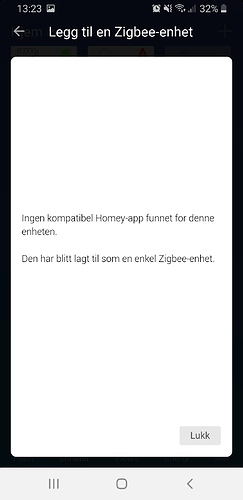

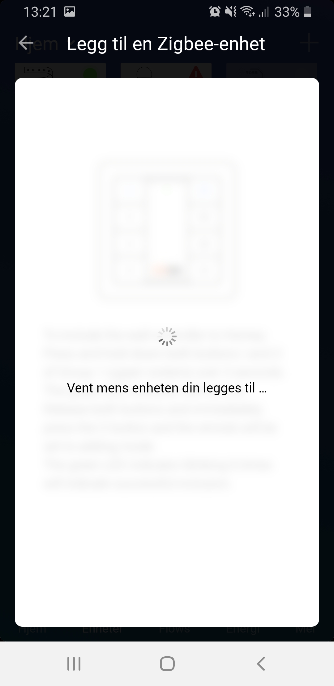

Okey, sorry about that. I have no clue how it got added to EasyHome though. Can’t remember neither installing nor using EasyHome. Anyway, I uninstalled the EasyHome App, set the switch back to factory reset, and tried to add it again with the Robb smarrt app. Now I’m back to the original problem; I press and hold the I and O and then the O button. It looks like it starts pairing mode (switch blinks several times and app starts “working”), but it only results in the following message: “No compatible Homey app found for this device. It has been added as a simple Zigbee unit”.
In norwegian, but says “No compatible Homey app found for this device. It has been added as a simple Zigbee unit”
For some reason looks like I’m not able to add it to the Robb app.

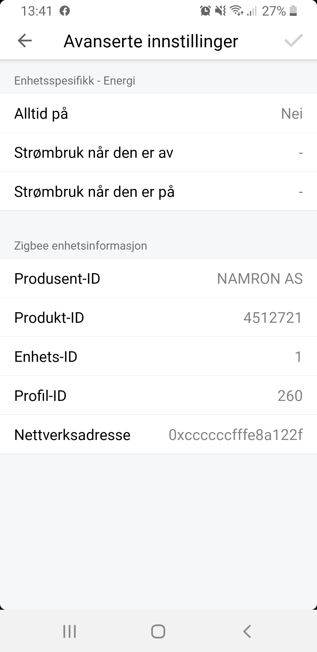

Can you show the advanced settings of the Generic Zigbee device, showing the ID’s that are being used to identify the right app?
You know what… I think there is something wrong with the device itself. I had another one, looks exactly the same, but another providor (Sunricher insted of Namron), and it works. :-o
Really sorry for using your time, but appriciated a lot that you tried!
