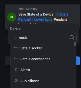

not sure it has been already reported, but searching for devices (filter) when creating flow, doesn’t work unfortunately, same for Zone selection…

Hi @Sharkys,
I am not aware of such an issue. Both search boxes work as expected for me.
Do you get any errors popping up in the homey app when trying to?
If you have a large amount of devices or zones it might take a moment until the selection shows.
Can you reproduce this and send me a diag report for the app, maybe I can see something in the logs.
I mean (same behavior in the mobile app) :

Ahh gotcha. I will have a look into that. It might be that the search filter is not respected.
Fixed in coming v3.1.1 release
