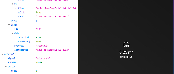

But i have too another task according measure Rain.
results on display is in Rain sensor. according compare measure on original display it is not sqare meter but mm of rain fall. In this diplay maybbe is nice to have cumulative rainfall per day, week month. maybee to possibility for reset cumulative to zero. this is only idea.
many thanks for your great work
Thanks again for testing @KarolG.
Rain data is a challenge indeed. I’m using the default Homey capabilities, which offers:
  • measure_rain: Rain in millimeter (mm)
  • meter_rain: Rain in Cubic Meter (m³)
I really wouldn’t know how to convert total rainfall in mm to m³ when there is no surface size to relate to.
What would have been more logical in my view would be:
  • measure_rain: Rain rate in millimeter/hour (mm/hr)
  • meter_rain: Rain total in millimeter (mm)
So to fix this, I would need to create custom capabilities. I’ll think about this one.

Have you considered making it a sub capability by defining measure_rain.total and then giving it a new title using the title option in the app.json?
I have done this with my app and it works well.

@Adrian_Rockall Thanks for the tip, but making it is sub-capability does not solve the unit. Sub-capabilities use the same unit. But creating a custom capability does not have that restriction.
But at least the units for both are in mm which is more logical. The title tells you what it is.
