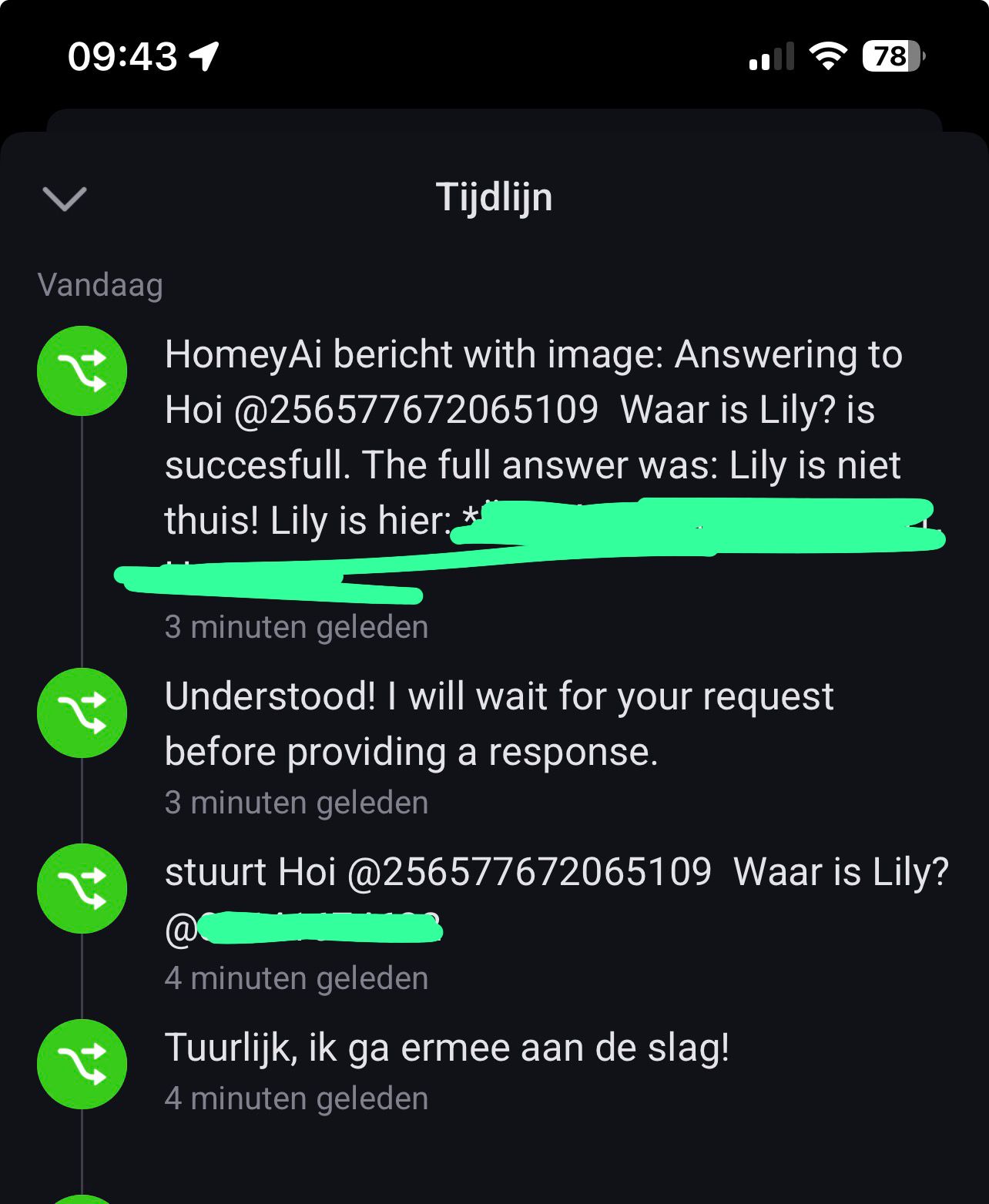

@martijnpoppen I have a return messages so everything is fine for my issues.
