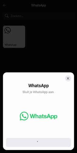

Unfortunately, I can’t.
Homey restart, app restart. Neither worked.
This is a Homey Pro 2019 with version 12.6.1.
WhatsApp version 1.33.0.
By the way, I can’t add a new device either; there’s an exclamation mark.
@Marco0499 ask homey support
If you can’t add devices it out of my hands
it is only when adding a whatsapp “device”.
