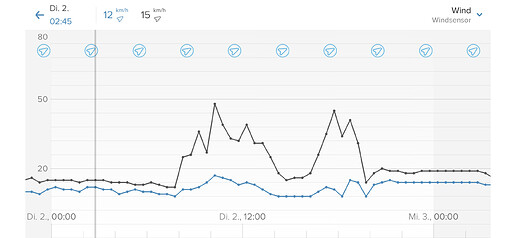

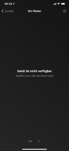

since 02 March around 2:00 a.m. the connection to the weather station was interrupted (see screenshots). However, the weather forecast is still working.
The weather station is accessible with other programs (Netatmo, Netmo for Mac, myatmo for iOS, WeatherPro for iOS) and there is/was no interruption.
I intentionally haven’t deleted the device/weather station yet and tried to add it again because you may need a diagnostic report.
Do you know of any problems or changes on the site of WU?
