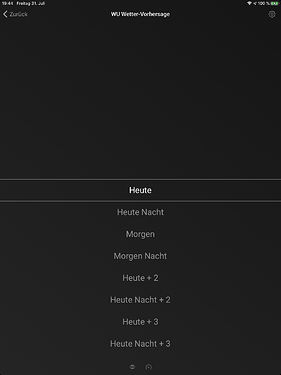

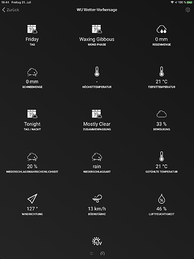

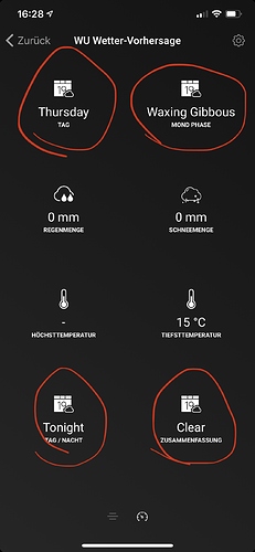

By the way, the following information are not (any longer) translated into German:

The parts that are not translated in the image come directly from WU. I send the language code with the request so WU should return it in that language. I will check to make sure the request is still good.
Adrian, PM.
I have checked and the German language file does have “de-DE” for the language code. If I replace the “en-GB” in the English language file with “de-DE” then I do see all those message in German so the link is working. I’m not sure why you are not seeing the correct language there.
If you enable the log in the configure app section you should see the URL that is being used.
I actually have the “en-GB” setting, but I did not make any changes (except adding the wind sensor).
Neither on wunderground.com nor on the website of my Netatmo PWS I found nothing where I could change the language setting. But the position of the PWS is correct.
That’s strange as it is one of the translation strings located in de.json. That file also holds the translations for the pairing wizard such as “Informationen Ihrer Weather Underground Station.” and “Wetterstation hinzufügen”. Homey should automatically fetch the text from that file when the language is set to German but it looks like yours is fetching from en.json. I also have a nl.json for the Dutch language.
To test that WU was returning the correct language I changed the text in my en.json file and it was picked up from there OK. However, I can see that it is picking up all the other “de”: translations from the app.json file so you obviously have Homey set to German.
