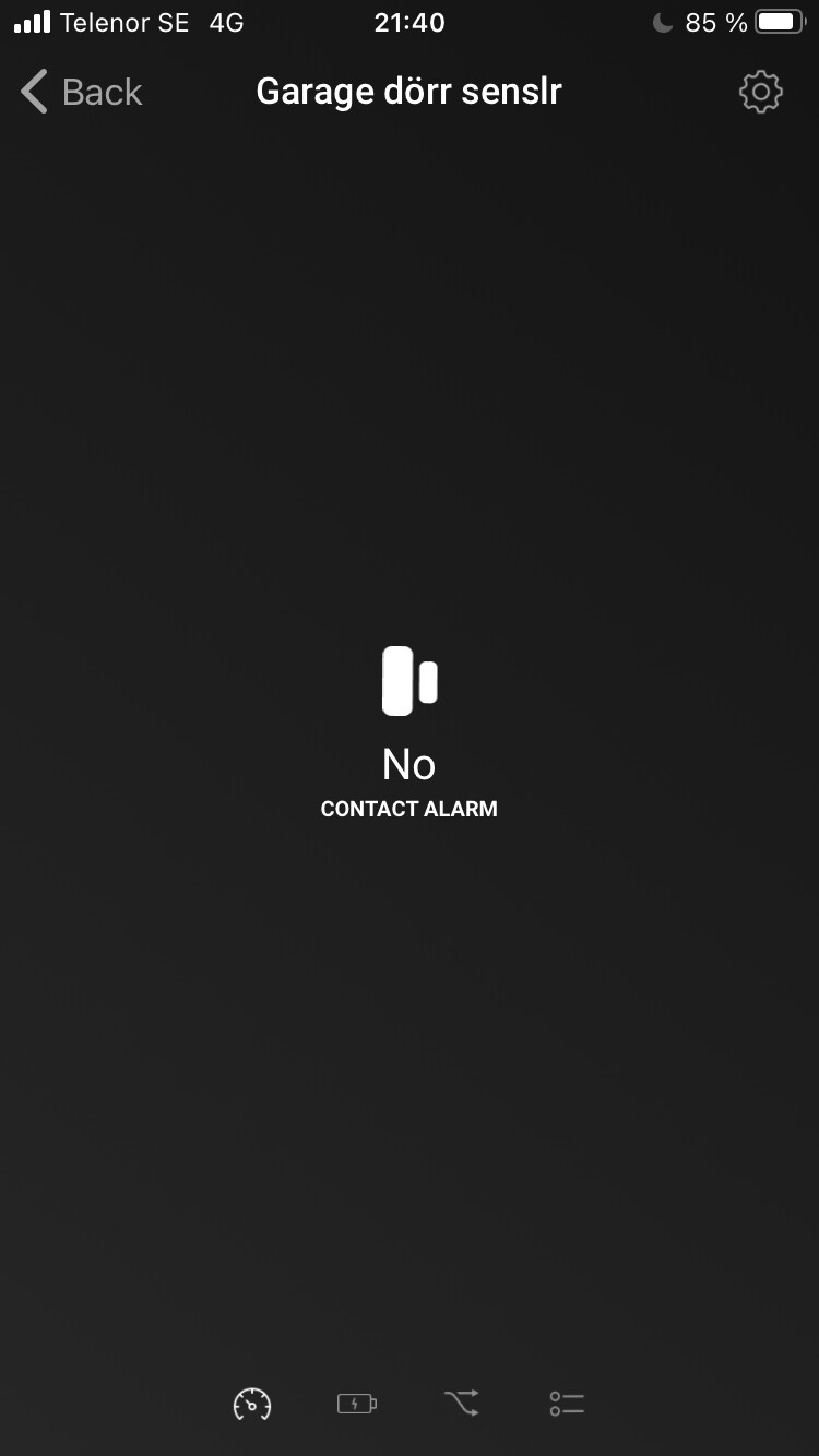

Unfortunately there is no difference for me. I tried everything including exclusion new battery restarted close etc…
Now I see the No Contact status page, but when i try the sensor it does not indicate any change status.
Tried restart the app but no change, I haven’t tried to remove and adding it again yet but I guess it is something else.

First I installed your app and the ZP3102 device didn’t responded in the app. Then I deleted the device and included it again. Stil nothing in the app. Version 2.0.2 doesn’t seem to make any difference.
The app doesn’t ‘read’ any information from the device.
Movement, generic alarm, tampering and temperature information.
See attached screenshot.
