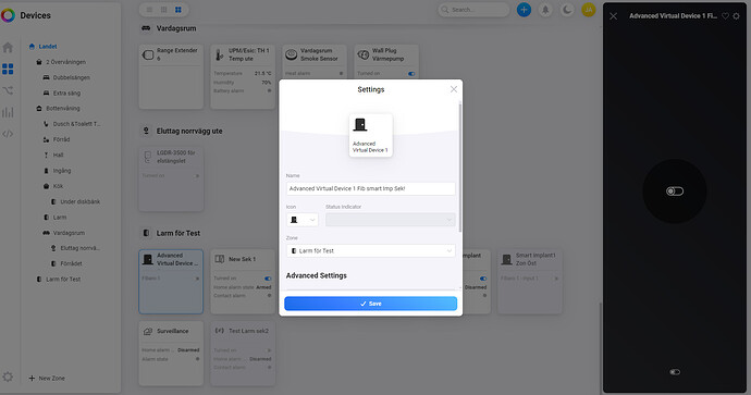

Could you make a screenshot of that window? I think you are misinterpreting the screen.
Did you succeed in all 13 steps of Peter Kawa?
Hi!
Enclosed you’ll find my 3 screenshots. The first is from the Fibaro app.
Here you can see the Fibaro Smart Implant 1 Zon Öst As I wont to have it Alarm input 1 equal too Input one. This I wont to have to trigger Heimdal and activate Alarm chain.
The next two screenshots are from my try to include this Fibaro Smart Implant to AVD, as you can see it will report as an Electric sensor and I wont to have to be an electric switch or button. H
ope theese screenshots make sence to you.
Regards
Jan A
The energy field you can fill in the energy the Fibaro Smart Implant itself is using. So Homey can calculate the power all your devices are using.
However you have to continue from step 6, and right click the tile and open the menu “Maintenance” not “Settings” and continue till step 13.
