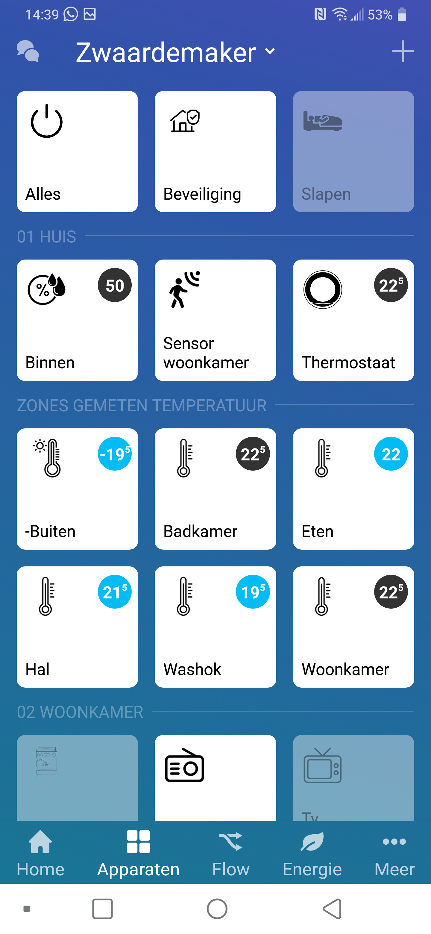

Nice, and how does it look on the tile?
For example will -29 shown correctly?

It does:
And what about negative double digits? :wink:
But even if not, that’s what I need.
I have added this one until -20 and displays ok

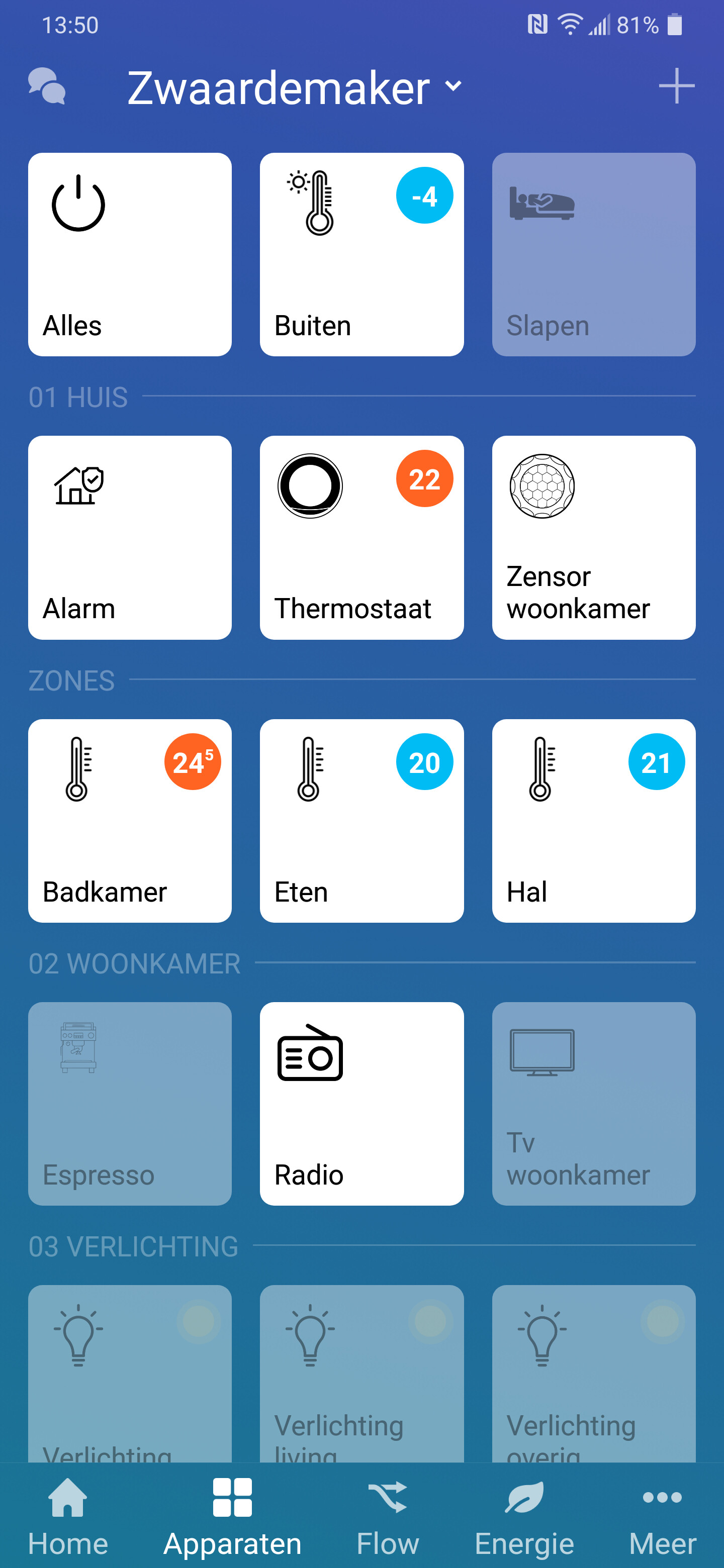

How do you get those blue tile numbers? Perhaps you can share a flow?
I’m on v0.9.4 and can’t input a “minus” in the attribut field min target_temperature of the VD thermostat device.
It an older version where i added pics myself and added the negative for temperature

Its possible to adjust the range on the termostat when you add it​:blush::blush:
Also add icons
Very nice!
