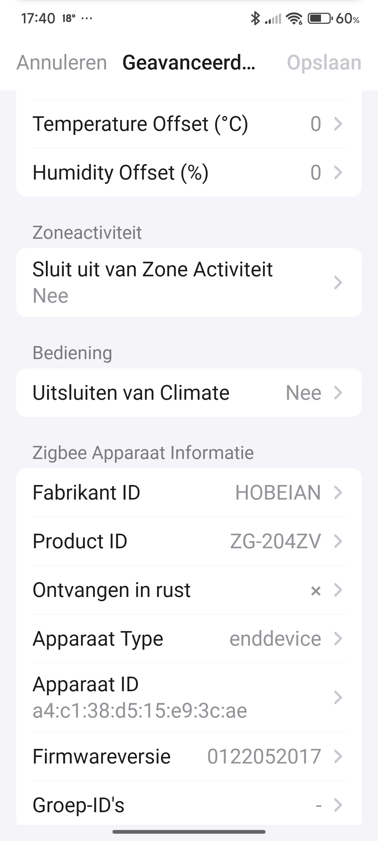

Hi Dylan, I’ve seen you’ve been working on it again, so I gave it a try again.
Added the HOBEIAN multisensor and first of all it was connected but then it came with an error Device not found try to reconnect, did this several times but no luck :slightly_frowning_face: see diagnostic report and screenshots.
6be8deb6-9368-4359-88ff-4ba5626d3526
Also tried to add the SOS button but seen only as a Generic device.
Thanks again and best regards Peter.

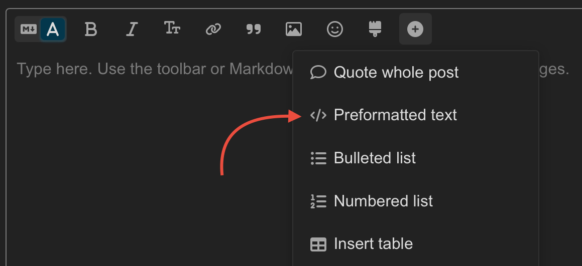

Tip: if you apply the ‘Preformatted text’ option to the original code output (like JSON code), it will be formatted nicely and more readable.
Wow this text is too compact :eyes::sparkles:
