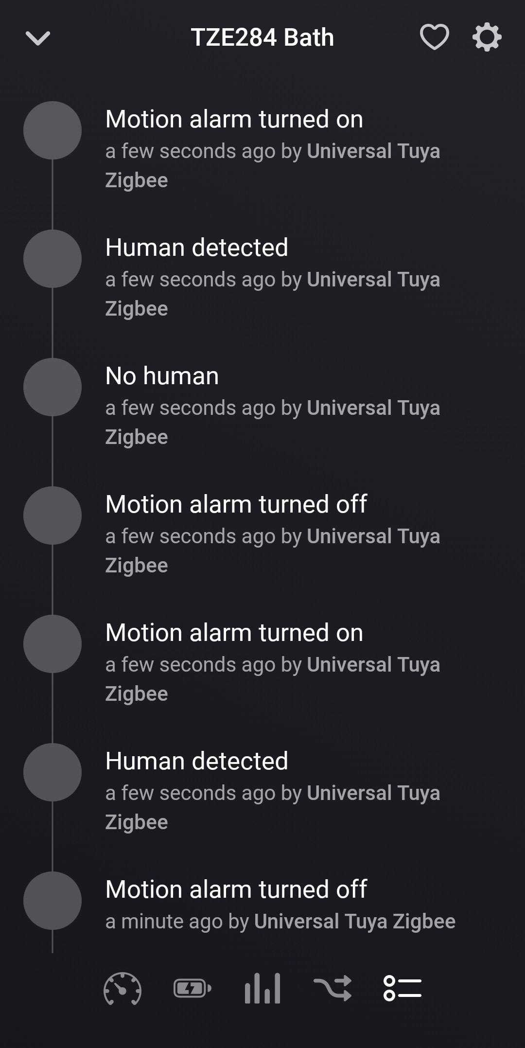

_TZE284_iadro9bf:
It goes on when entering the room, but when i am inside it it goes on and off
Lux is showing 30 and 2000 every 15 sec.

I’ll think we can just give up on the _TZE204_gkfbdvyx and _TZE204_gkfbdvyx
I it just to far off still. Goes on when no presence. Lux is not working. Battery alarms. Distance not working.
