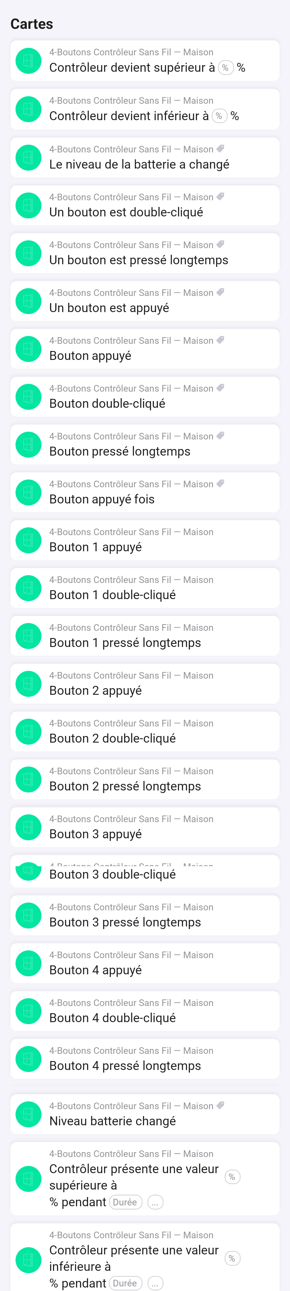

The button is now recognized as “4 boutons contrôleur sans fil” :grin:
but the physical buttons don’t work, and the battery isn’t updated.
The button work when i click it in the app (capture), but not when I click on the physical module
In the flows, there is too much “when” cards I think, like “bouton appuyé “ and “un bouton est appuyé” that seems to be the same
And I don’t understand the “contrôleur devient intérieur à x% “ etc… when cards
Thanks again !
i think it’s about the battery percentage ; “ontrôleur devient intérieur à x%” do you have any diag log after pressing buttons ?

About the flow cards:
  • “bouton appuyé” = generic card (works with any button + token)
  • “un bouton est appuyé” = Homey’s built-in capability card
  • Both are intentional for flexibility - use whichever you prefer!
Please let me know if it works after re-pairing!
