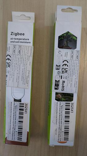

You requested more information about the soils sensor. I bought it from Aliexpress and I’ll add pictures of the packaging below.
I hope this helps. Keep up the good work!

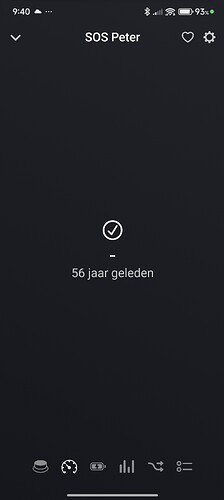

Hi Dylan Good morning :sunrise_over_mountains: you had a short night sleep :sleeping_face: you’ve been busy all night :pleading_face:
I followed your instructions to reset my devices, installed Ver 3.0.43, restarted Homey and paired my device’s again and that went flawless now :+1:t2:But unfortunately it didn’t solved my problems, SOS button no battery reading now and no response pressing the button last reading 56 day’s ago and also not triggers the Flow.
Multisensor able to add now but no readings at all no data and no battery. Last data 56 day’s ago.
Diagnostic code: 54e90adf-069d-4d24-bb66-83372cadc817
I hope you be able to solve this nasty problem.
Good luck and success and have a nice day.
Best regards Peter.

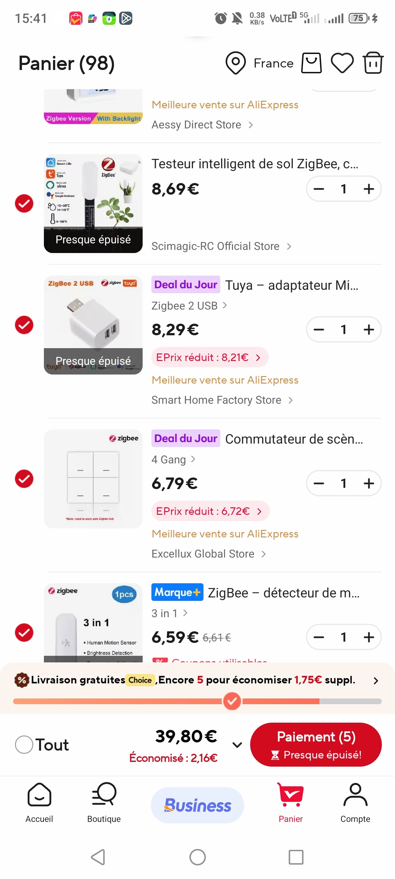

I think I will buy all this devices be
cause I need more infor to debug
Is it the right device and the right configuration
Hi Dylan, sorry for the late response because I was out all the time :roll_eyes:
The 3 in 1 is probably the right one, but you never sure because it can be different hardware inside.
But I will pay it for you and if you need an SOS button as well.
Best regards Peter .
everyone can try ot now i have made an new commit and push
link of sos button please
Hi Dylan good morning,
Here the Link for the SOS button:
https://a.aliexpress.com/_EQt105W
I only payed € 4,25 a piece for it.
And I’m going to try your new versioan and let you know if it works.
Have a nice day and
Best regards Peter.
