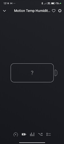

Hi Dylan Good morning, No readings at all on Multisensor last seen 56 year’s ago and SOS Button only battery reading for the rest last seen 56 year’s ago.
Using app Ver. 2.15.125
Diagnostic code: 6c8e96e2-06b1-4c1e-aa45-ed47923a71f2
I hope you can fix it and keep up the good work :+1:t2:
Best regards Peter.
I just tried with version 2.15.124 to add my devices, but the temperature sensor is still added as a smoke detector and the soil sensor is not added.
Diagnostic code is: cf04e00e-9df5-4424-91e1-3f83c4407194
Hopefully this helps the development, keep up the good work!!

Hi Dylan Good afternoon, Multisensor got Temp reading now, rest no data last 56 year’s ago and no battery data. SOS button no changes just Battery data.
Also no respons in flows on both devices.
Diagnostic code: f7f91827-5e5e-4445-b0d9-b9a21bdfa2ea
Good luck again.
Regards Peter.

Hi I’m on ver 3.0.7 now, restarted and installing Multisensor and SOS button.
No readings at all no data no battery and no triggering.
Diagnostic code: cf19866c-1fc1-4c53-ba44-f87e05df41d3

### Hi Peter! :waving_hand:
Thank you so much for your detailed diagnostic report! I’ve analyzed the logs and **I have great news** - I’ve identified and **fixed the exact issue** you were experiencing.
### :magnifying_glass_tilted_left: **What was the problem?**
Your diagnostic log showed this critical error:
TypeError: expected_cluster_id_number
Endpoint 1 clusters: basic (0xNaN), powerConfiguration (0xNaN), …
Error: could not initialize node
**Root cause:** The drivers were using literal cluster ID numbers instead of proper CLUSTER constants, causing the Homey ZigBee Driver to fail validation with NaN (Not a Number) errors. This prevented your devices from initializing completely.
**Impact on your devices:**
- :cross_mark: Multi-Sensor: No temperature, humidity, illuminance, battery, or motion data
- :cross_mark: SOS Button: No alarm triggers, no battery data
- :cross_mark: Both devices: Complete initialization failure

Hi Dylan, only temperature data and no battery level reporting, SOS button only battery reading but no triggers from button press.
Diagnostic code: 79185556-0ad6-4572-a233-aa16dd94e15c
Good luck you’ll get there inventually :+1:t2:
Regards Peter.
