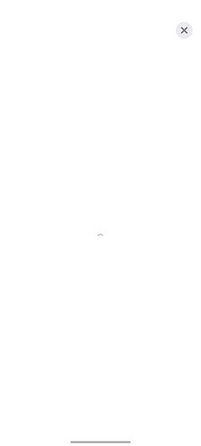

Ok… Now it doesn’t get past this screen (after selecting the Tuya Zigbee device I want to add)
So, the turning circle. The next screen should be the standard screen you get when adding Zigbee devices.
And after cancelling out I tried adding a generic Zigbee device, but that doesn’t get past this screen as well. And the app is back to the non development version
So, installed the development app one more time and restarted Homey after that.
Edit: For the time being, I give up. There must be something I am doing wrong here. And most likely for the experts this is a no brainer.
