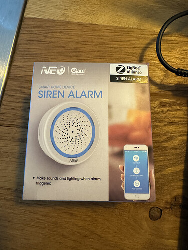

in the tuya app I see that the siren is available:
but if I try to add its an unknown zigbee device
this is de device box:
Any thoughts?
It’s likely the well known tuya issue. Device might be fully supported but you got a device with different device and/or manufacturer IDs. Those need to be added to the code first.
I would check the Neo Coolcam app instead of the Tuya Zigbee app. (NEO Coolcam App voor Homey | Homey)
This isn’t a Tuya device… :wink:
Good idea @Rikjes , but it seems that the NEO Coolcam App only support z-wave products.
yes so that doesn’t work, the product stated that it should work with Tuya, and because of the devices looking so similar I thought that it could work
