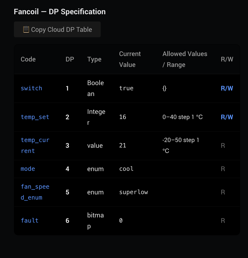

Some troubles to get my new fancoils to work with Tuya local. At the first attempt one of the fancoils did connect. I could control it, but the second one wouldn’t. So i removed the working one to check if it had to do something with multiple instances. But now both don’t get connected anymore. The first attempt was adding it as a heater, later i tried airconditioner because it has also modes for couling, heating and dehydrating. But also going back to heater doesn’t change things.
I the configuration i can retrieve the devices, even see changes made in the tuya app reflected in this screen. But ECONNRESET is the message as soon as i install the device in homey.
Tried all the protocols manualy. Protocol 3.3 seems to connect fine during setup, but also results in ECONNRESET as soon as connected as a new device.
The scanning for protocol says it can reach the IP, port 6668 is known.
Not sure how to continue from here on.

@Kringloper
Two things to check:
In the pairing screen, press Scan network. Each device found is listed with the Device ID it broadcasts. Compare the ID next to 192.168.2.70 with the Device ID in your device’s settings. If they differ, that’s it — correct the IP (or the ID and key) so the pair belongs together.
Give both fancoils a fixed IP in your router. Two Tuya devices swapping addresses over DHCP produces exactly this, intermittently and confusingly.
Also, if you re-added either fancoil in the Smart Life app at any point, the Local Key changed. Re-fetch both under Cloud Lookup.
Two settings to correct while you’re there, independent of the connection:
Fault DP is set to 20; your device reports fault on DP 6.
Fan speed values is auto,low,medium,high,turbo, but your device reports superlow. A Tuya device silently discards a value it doesn’t know, so fan speed commands would fail without any error. Set it to match what your device actually offers — superlow first, then whatever else it reports.
Send another bundle after the scan if it still won’t connect, and include what the scan showed for that address.

The mixup of the two devices was the problem. I made fixed ip addresses but at that moment i registered the wrong name in the dhcp table. So every time i made the combination of the fixed ip address and the device it was the wrong combination. It is all working now. Thanks.
