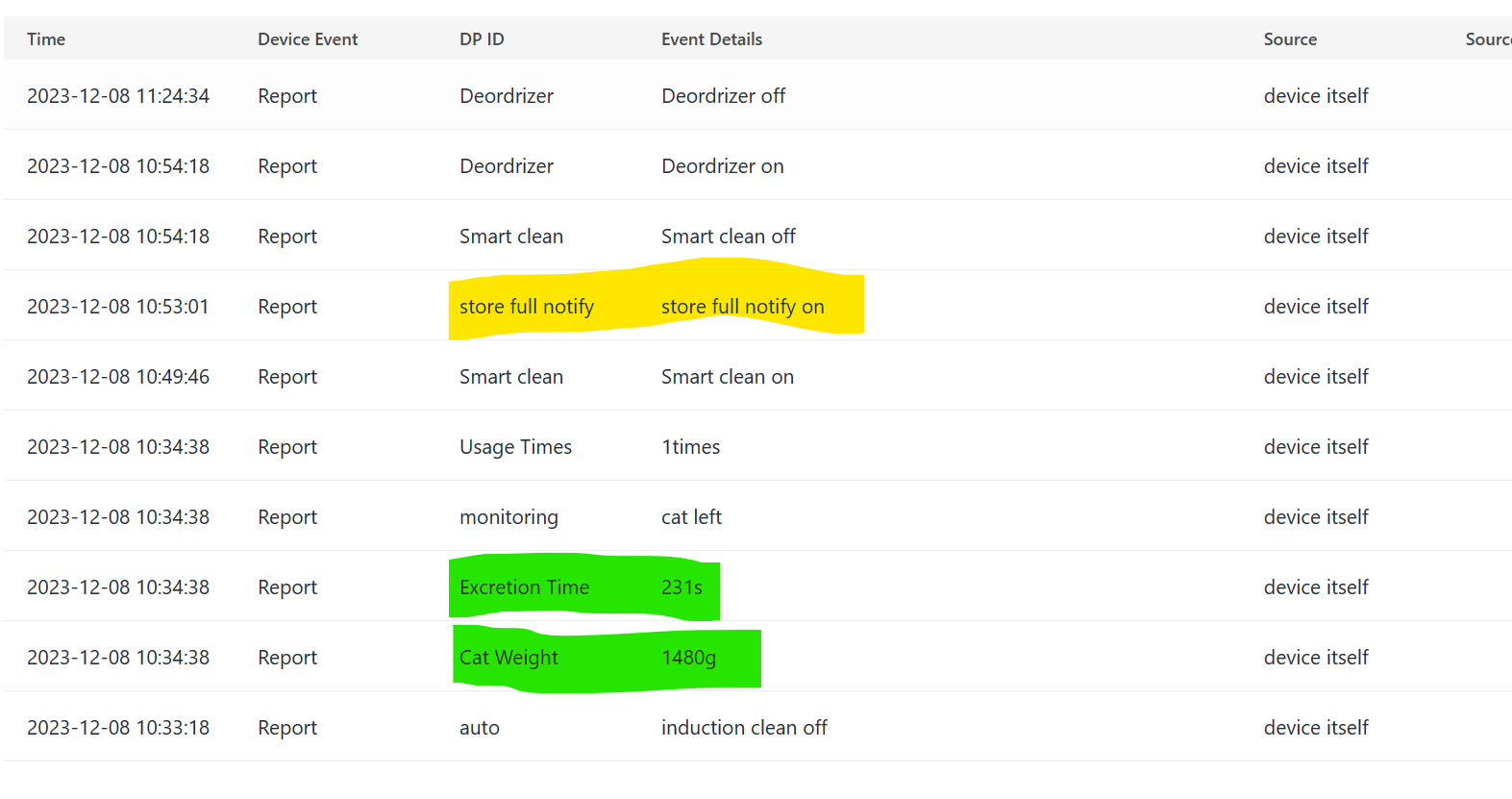

I wanted to reach out with a question regarding the listening to devices and reading their actions. I’ve been reading out my smart cat litter box and what it logs but it appears as not all messages are received (I’m listening to Text, Boolean and Number). For example, I consistently get lines written when my litter box detected the cat has done its need, as per below;
  • [flow Tuya Text Event Msg received] Device ID: (xxxxxx), Function name: (cat_weight ), Function value: (1480)
  • [flow Tuya Number Event Msg received] Device ID: (xxxxxx), Function name: (excretion_time_day ), Function value: ( 231)
But that’s about all received. When I then check my ioT platform and the device messages received it’s a lot more (and I’d love to use some of the other messages to let Homey respond with actions);
in green the ones that end up being received by Homey, the one is Yellow is an example of one i’d like to trigger on but is never received by Homey;
Looking forward seeing your thoughts and thanks again!

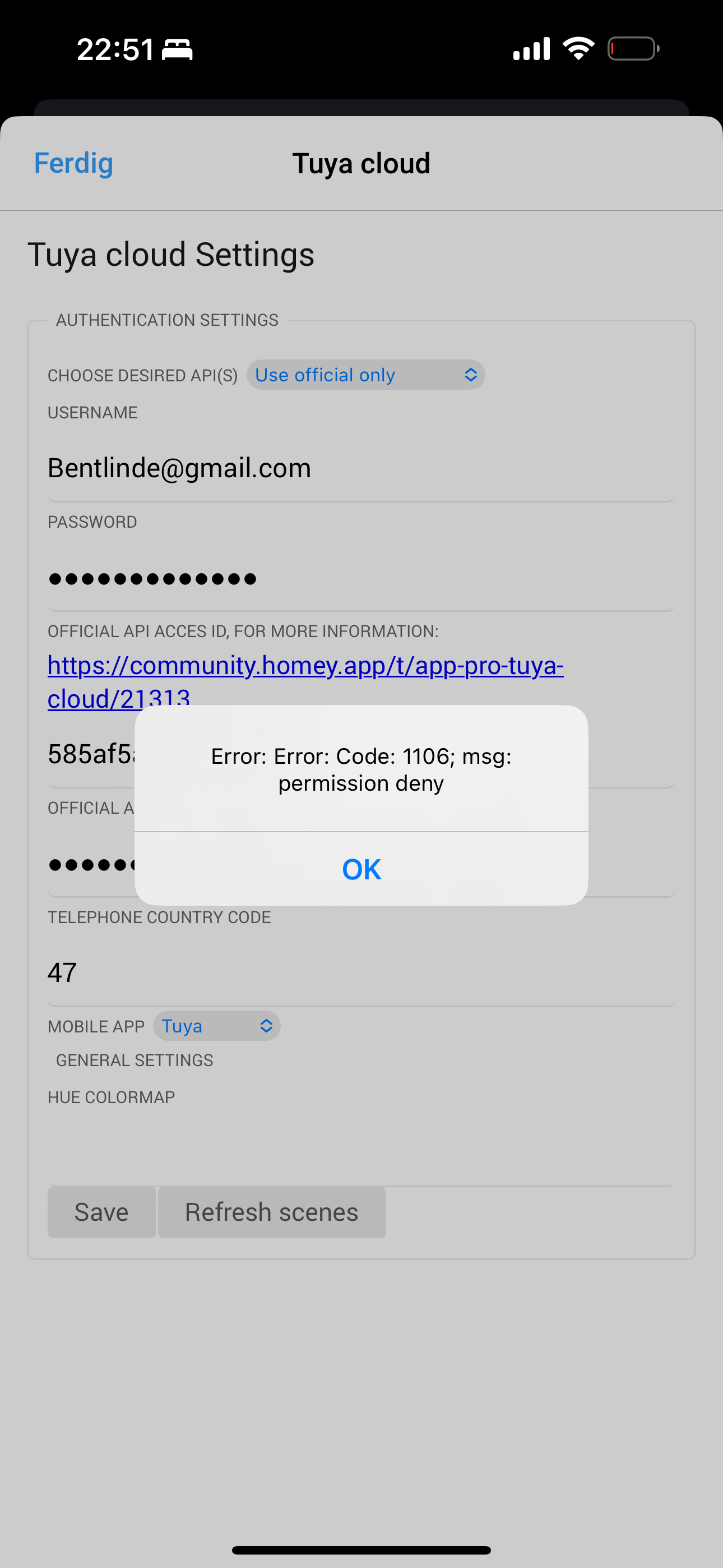

Hi, tried setting up, have linked accounts but get an error logging in the app in homey .
I checked password and username, and it’s all perfectly, ref, pic
Are you sure the account username and password are from the smartphone app, and not from the tuya iot login?

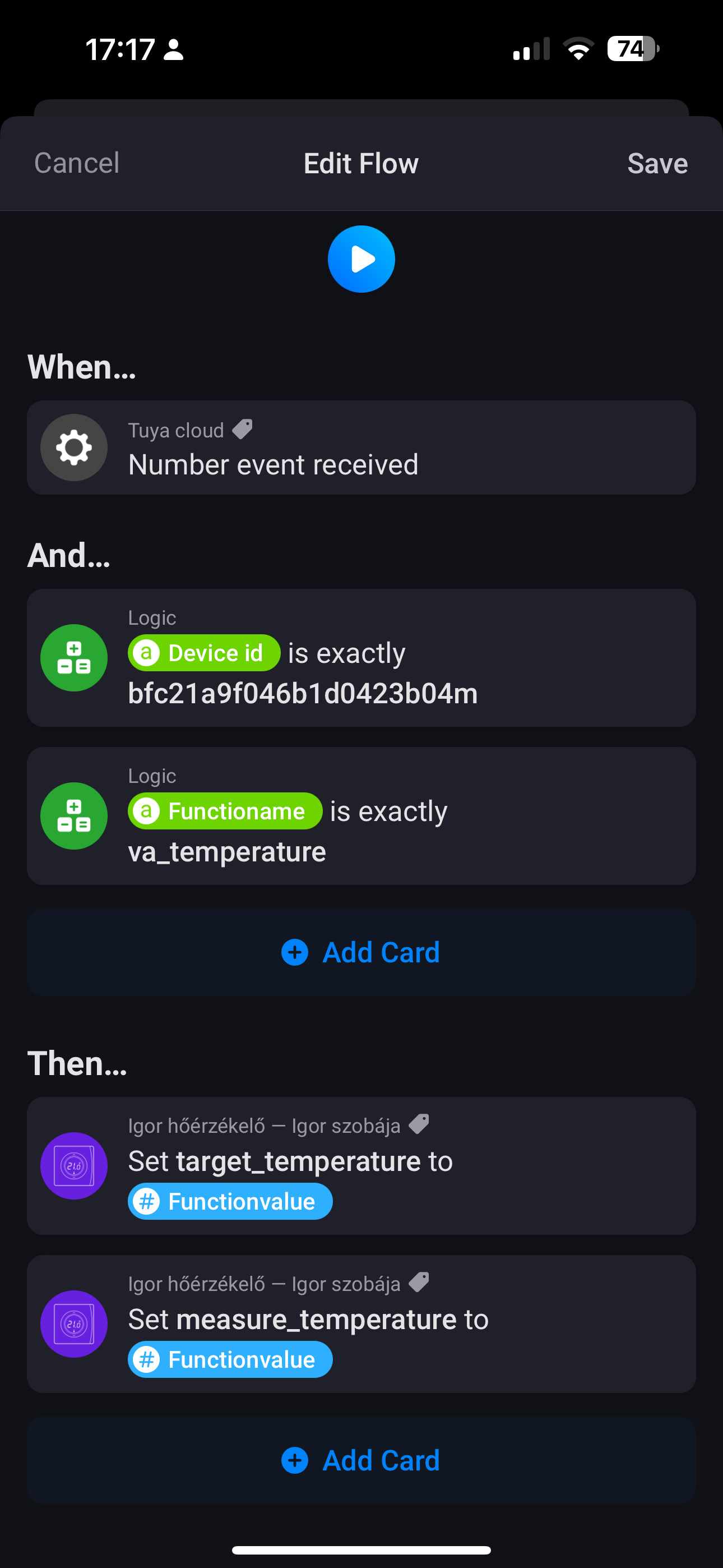

For example i made a virtual socket for my tuya smart plugs and made some scenes in tuya app and flows in homey bonded together. But im stucked w sensors. There is a way to make a virtual device which shows the actual temperature from the sensor? Or its impossible and i can do raw command like if the sensor say there is 24 celsius in for example room Y then turn off the Vthermo.
Actually i want to add a vthermo as a master thermostat and my netatmo gonna be the second one, because i want 24 celsius for my kids but at the grounc floor its always warmer at living room with like 3 Celsius difference.
My plan is something like this:
From 6pm my heat on to 8pm or until 24 Celsius reached in the children’s rooms (AVG celsius) by Vthermo. When its 24 Celsius then the sensor trigger vthermo which trigger Netatmo to turn off and Netatmo trigger after 10min my circulation pump to turn off.
Made something like this to read temperature (virtual device) but its doesnt work and the functionvalue is like if its 24 celsius the value is 240. How to divide functionvalue correctly with /10?
