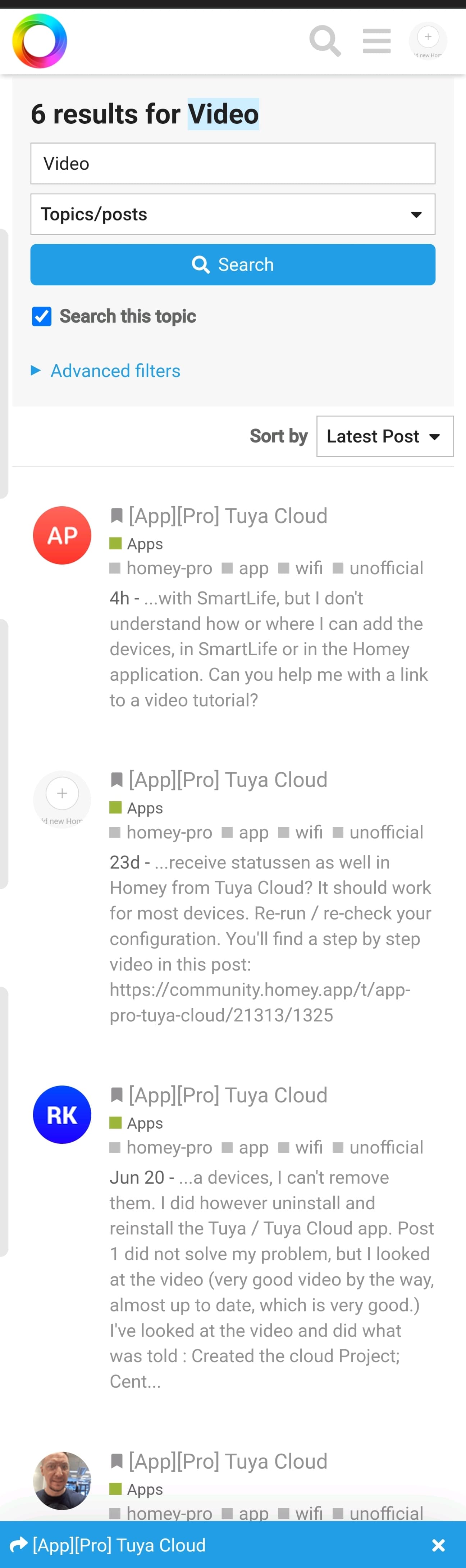

Use the search function please
But here you go:
Here you’ll find a link to a vid I posted earlier in this topic.

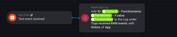

In the meantime, this flow sent 2 events to Simple log (but you can use Timeline Notif. for instance):
The green tags in the Simple log card, are provided by the trigger card, so called local tags:
The results in Simple log:

So – then the flow part – it’s there – seems identical right ?
So – what happens is – this does not result in any message in the log – I even tried actively triggering a simpler test – with a smart plug on/off on/off – nothing.

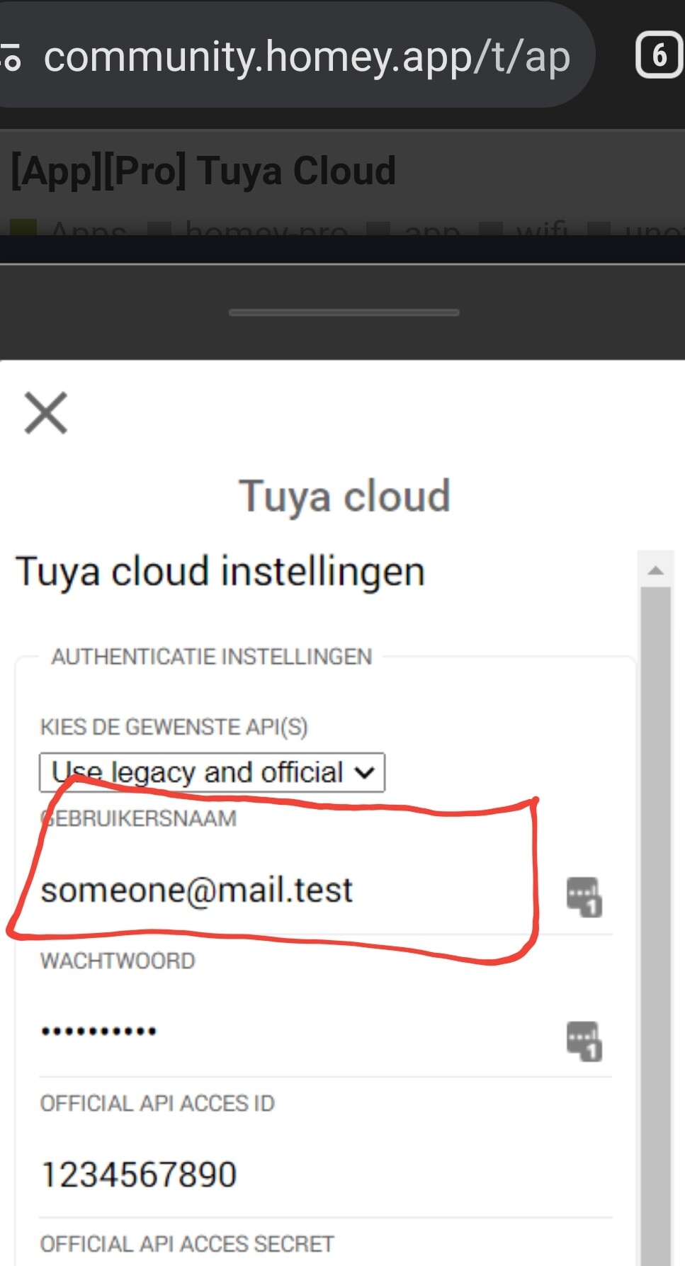

Probably this here is why they don’t reach your Homey (good catch!) I can’t see any other difference atm.:
This is the same email address as used for the Tuya smartphone app login, and also for the username in the Tuya Cloud app config:
What is the gg[longer number]? Is that the username from theTuya smartphone app login?
I think you should use the email address you registered when signing up for your Tuya smartphone app.
Yup. That’s perfect.
