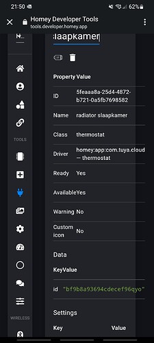

Can you please check in developer page for your device if the device id is the only value in this “Data” area?

https://tools.developer.homey.app/tools/devices

Hi there is only the id on the data sector

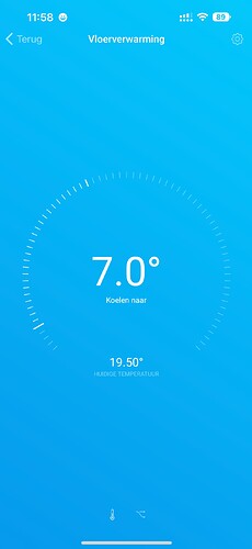

I make a rapport of the homey tuya cloud app when i change the temperature in the smartphone tuya apphere is the raport code:
0518b5fc-f956-41b9-a11b-6433b4732560
I reset the radiator knob to factory settings and removed the old device from homey, then reconnected it to the tuya app. and then re-added to homey
This is the app where i wil change the temprature of the radiator knop with this flow

Nothing, when i set it to 20°C in the tuya app the homey app stays on 15°C

And the data object has only the ID field. That’s correct, too.

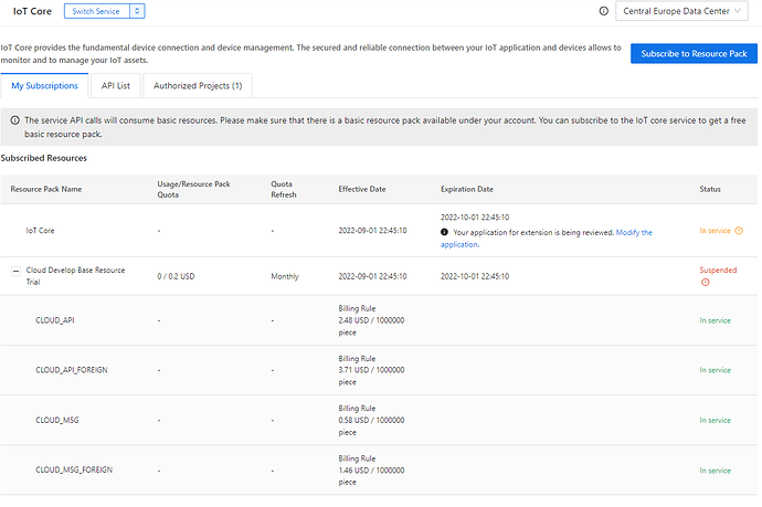

Thanks for your advice. I did all that. Very sure I use the right keys. When saving the config in the Homey app I get nog error, but a confirmation of the save.
Tried it all again today. Even unlinked en linked the app account on the IoT platform. No luck.
Then I saw that my IoT development trial is expired. Is that it? I requested an renewal of 6 months. But to be sure: do we need to keep this alive all time? Its not a free service, but a trial service…
The scale looks better now, but I cannot set the temperature anymore (version 1.1.17)
The iot Core does expire indeed so it seems.
I think your issue should be solved when your extend request is granted.

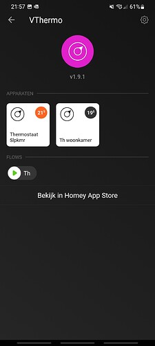

I hove no update, is stay in the 1.1.17
still i removed the button and added it again, but as you can see. does the button not respond to the thermostat
Screenshot_20221017-182730_Homey
homey is still not listening to the tuya app
It’s about the thermostat, Rick, not the button
