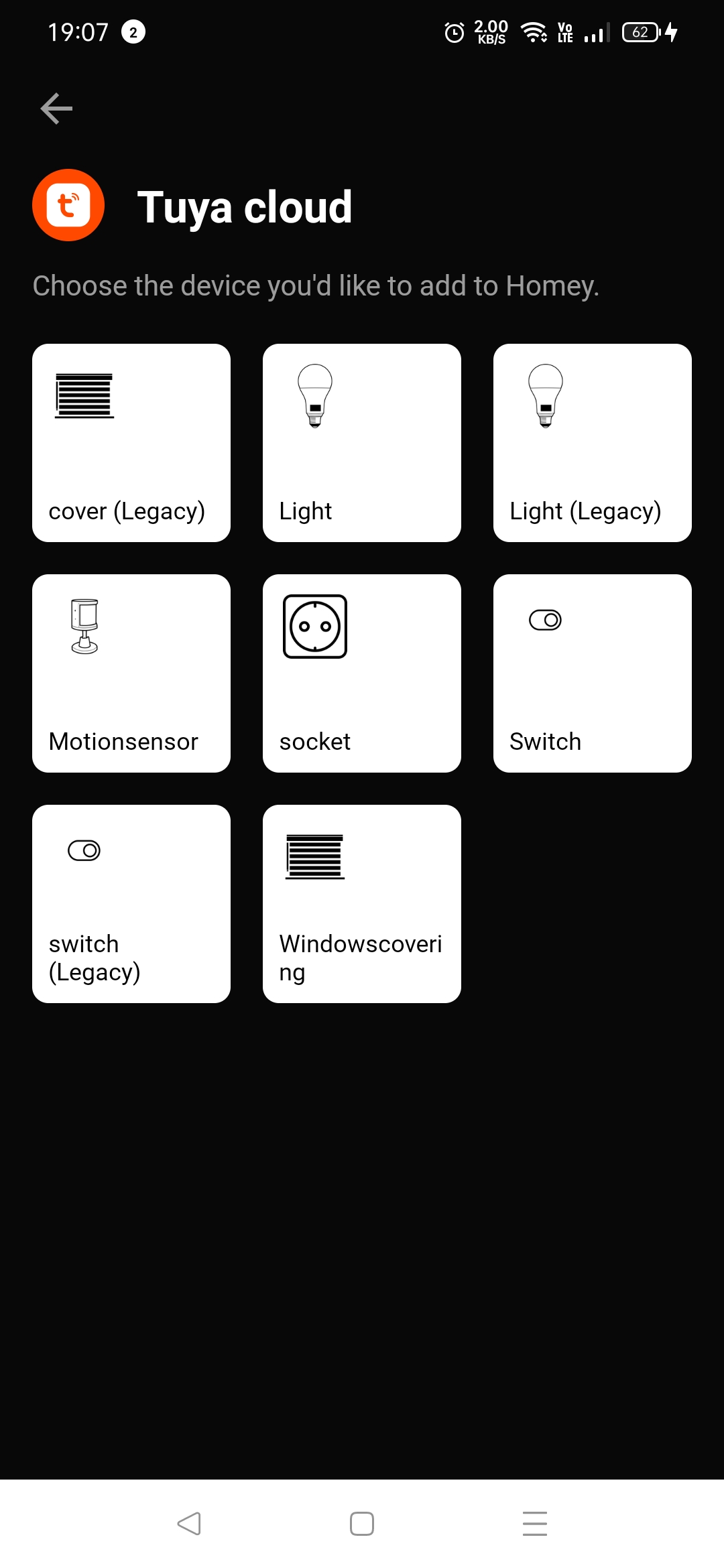

Hello, not sure if this has been asked earlier, i did look through a lot of these comments. But I can not seem to add contact sensors. When I add a device, i get these options only.
No way to add a contact sensor via the other devices either. PIR sensors work and relay/switches. Latest app and firmware. Tuya latest also.

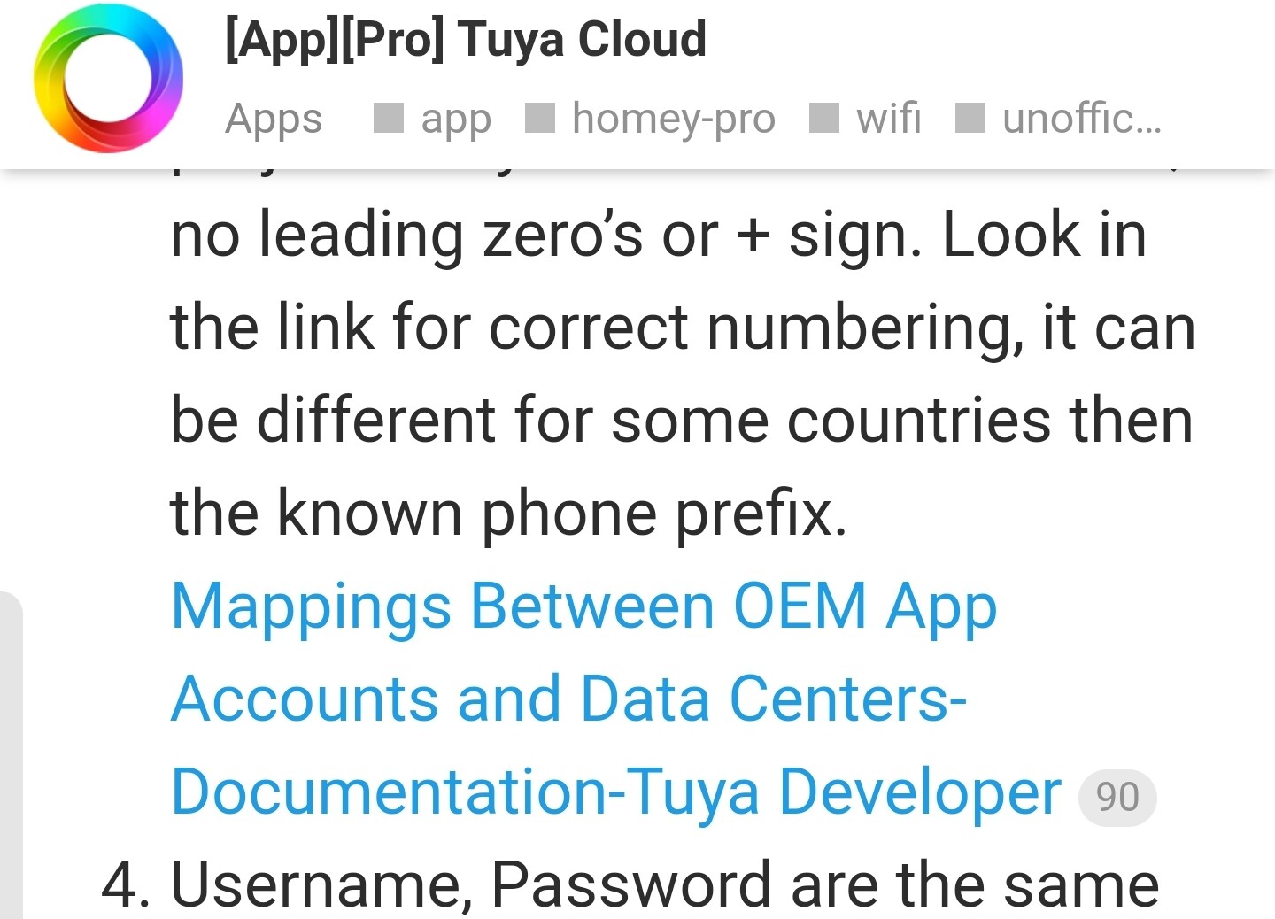

I found the problem for myself. I was using everything correctly except the datacenter. That fixed the “Please configure app first” problem for me.
I found this site which has the right information for datacenter linked to country. I was using Western Europe in Tuya IOT. I changed to Central Europe and it worked,
Idk, but the datacenter link is just in the manual at post #1

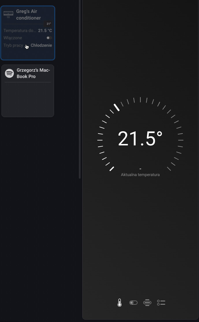

Hi @Jurgen_Heine I play a bit with code base this evening and I add new two devices.
Air conditioner and smart star projector.

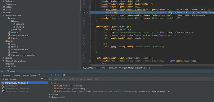

It’s my first steps in homey app, still don’t know how to properly debug apps
Star projector for now is just a copy of lights. But air conditioner kind works. I can send commands, but state is not refreshed when I turn AC by remote. Will try to fix it soon. Anyway. Can I create PR to your repo and ask for review when everything will be working and ready?
Thank you @Grzegorz_Zalewski, I like contributions to my app. When it’s finished I will of course look at the pull request. The getting started guide of Homey is good start to read: Getting Started - Homey Apps SDK. If you have installed Homey sdk on your node.js environment, you have to navigate into your node.js command prompt to root folder of the Tuya app on your machine. Then you can run the Homey commands. If you are using Visual Studio Code, you can attach the debuger after running the app on your Homey. When attached, you can set breakpoints and it can also break on errors. This last part I resently find out thanks to @Adrian_Rockall. One thing more, log as much as possible. All the logging is send when someone has a problem with app en sends a diagnostics report. Otherwise it’s verry hard to find problems.
Thanks @Jurgen_Heine I will try to fallow the rules.
I was able to connect debugger to WebStorm

New test version live with added airconditionor by @Grzegorz_Zalewski ![]()
