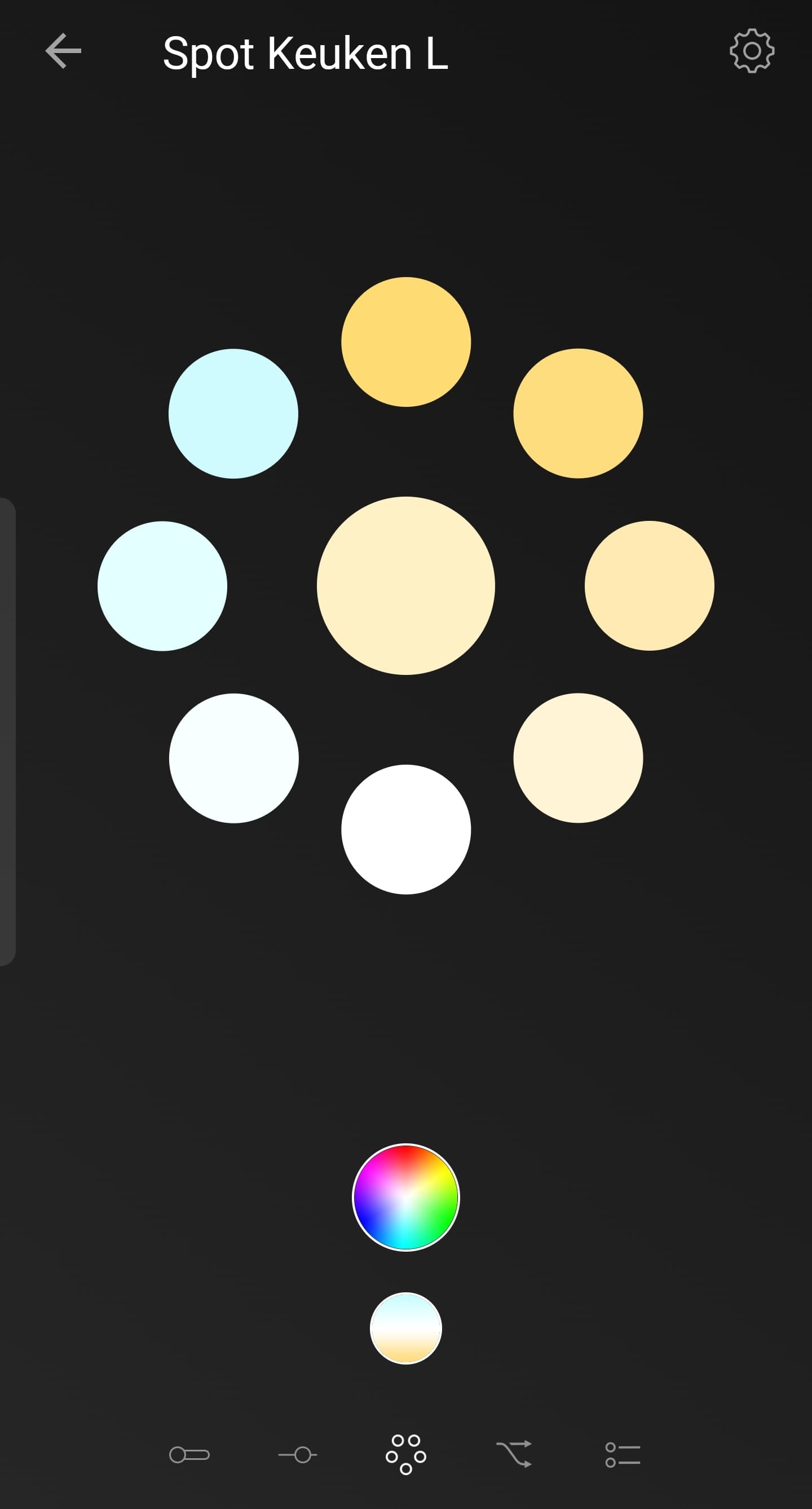

Anyone know how to get RGB options in Homey Pro? I use Tuya cloud app inside Homey… Thanks.
What do you mean? And does it work in the native app?
Yes it works in native app but want to control colors i Homey pro…

My RGBW lights can be controlled just fine. Otherwise use the tap-to-run method (search for the how-to in this topic)

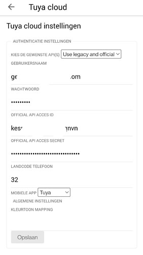

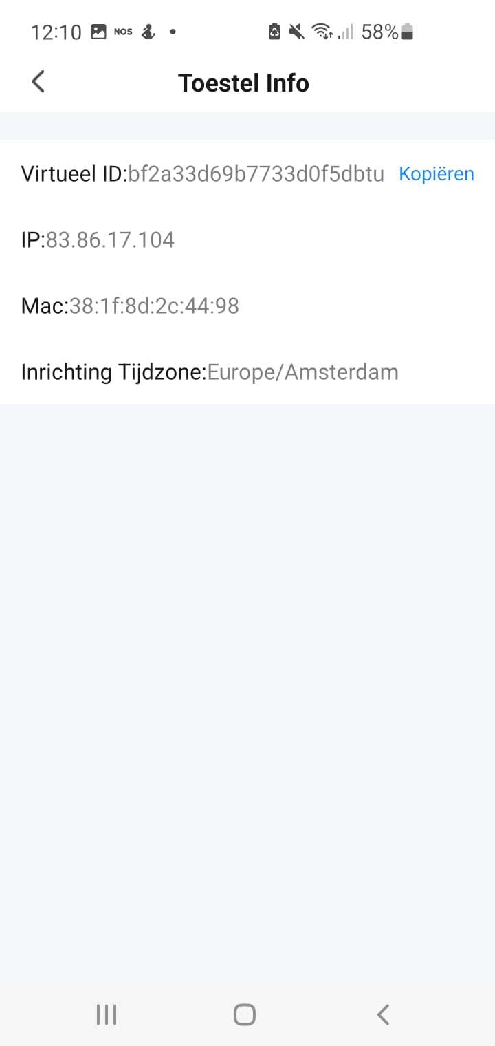

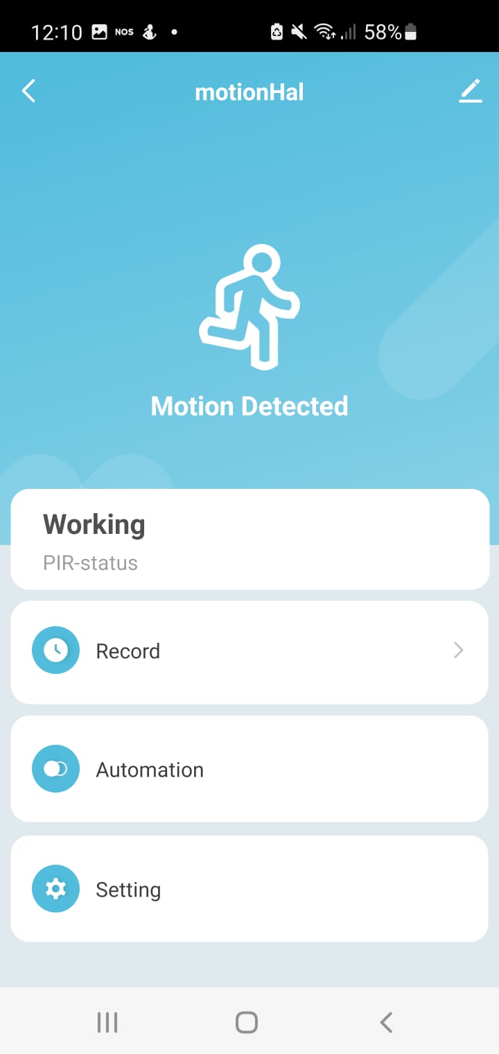

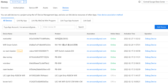

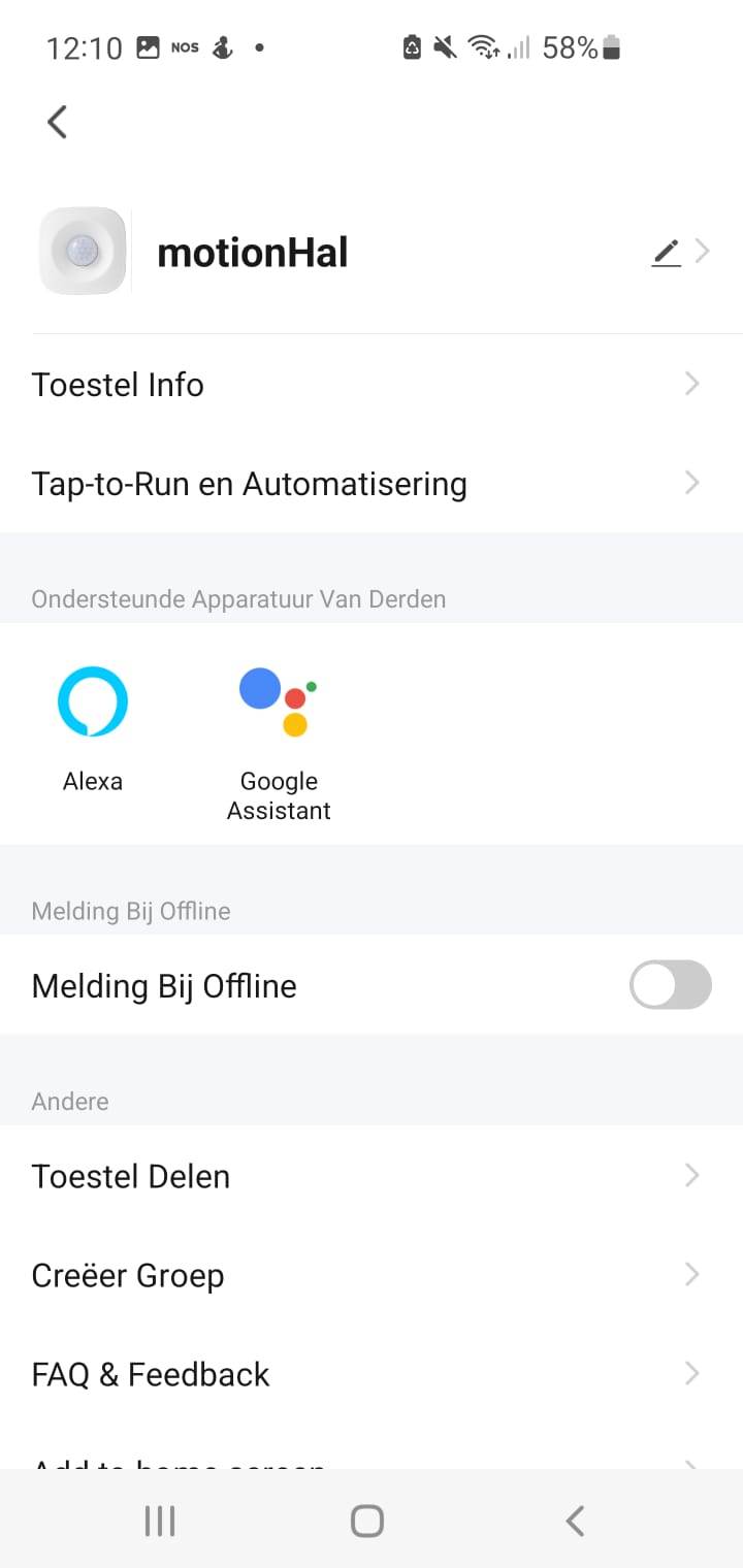

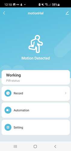

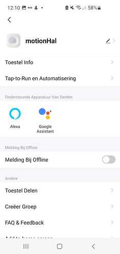

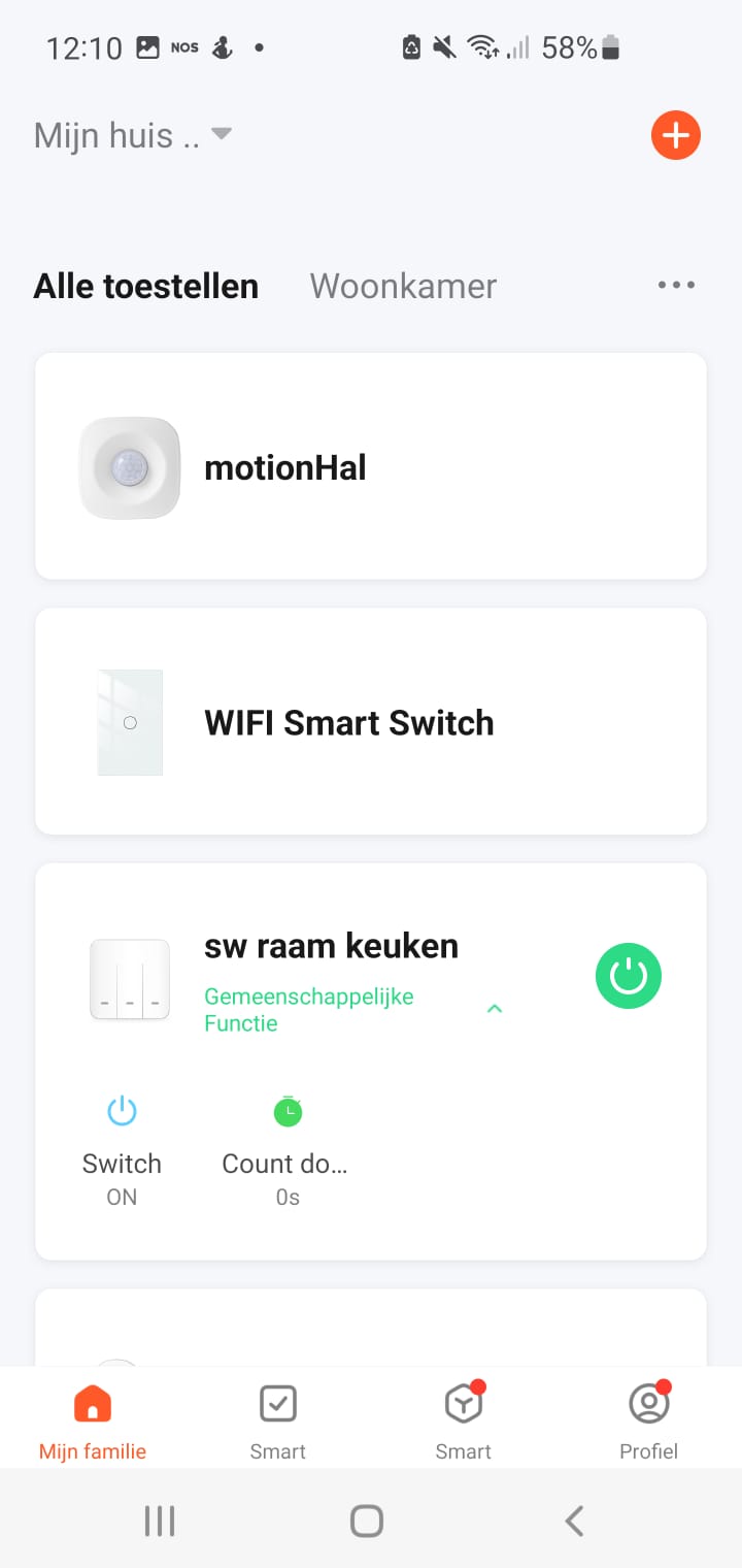

Hi @Jurgen_Heine, Can you help me with an issues. I’m using the tuya cloud for multiple devices and most work fine. You recently added PIR support so I tried to add my PIR however it does not show up in the homey app when trying to add it. The PIR is visible on the IoT platform portal as synced devices however the homey app show the message “Please configure the app first.” so it does not see a PIR or something. I’ve waited for more than an hour but still nothing to add. I added screenshot of all details of the device.
Thanks!
You have not done all steps for configuring official API if you get the message “Please configure the app first”. If the old devices are working, the username, password and business should be correct. So follow the steps carefully, look in this thread for extra tutorials and explanations. You only have to wait for legacy devices, new API should be instant.

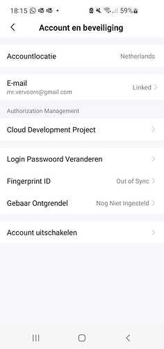

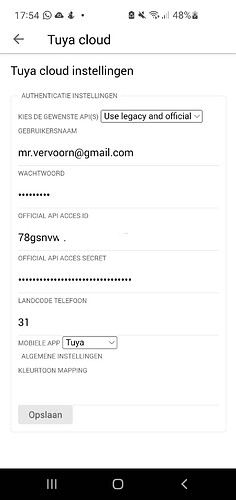

Hi @Jurgen_Heine thanks for you message. I have again follow all instructions and read the posts of @Jackass. I also looked at the instructions on Please configure the app first - in de Tuya cloud app - Zo doe je dat zelf. I also configured a new API on the Tuya IoT platform to start from scratch. But I keep getting the message that the app needed to be configured. I also try to configure it from app settings and more settings one of the solutions from @Jackass however it didn’t seem to help with me. I validate the API key and secret 100 times. What am I missing?
Only legacy devices seems to be working due to the username and password. I check all API configurations, country settings etc. Not sure what to do.
Below are screenshot of my configuration:
