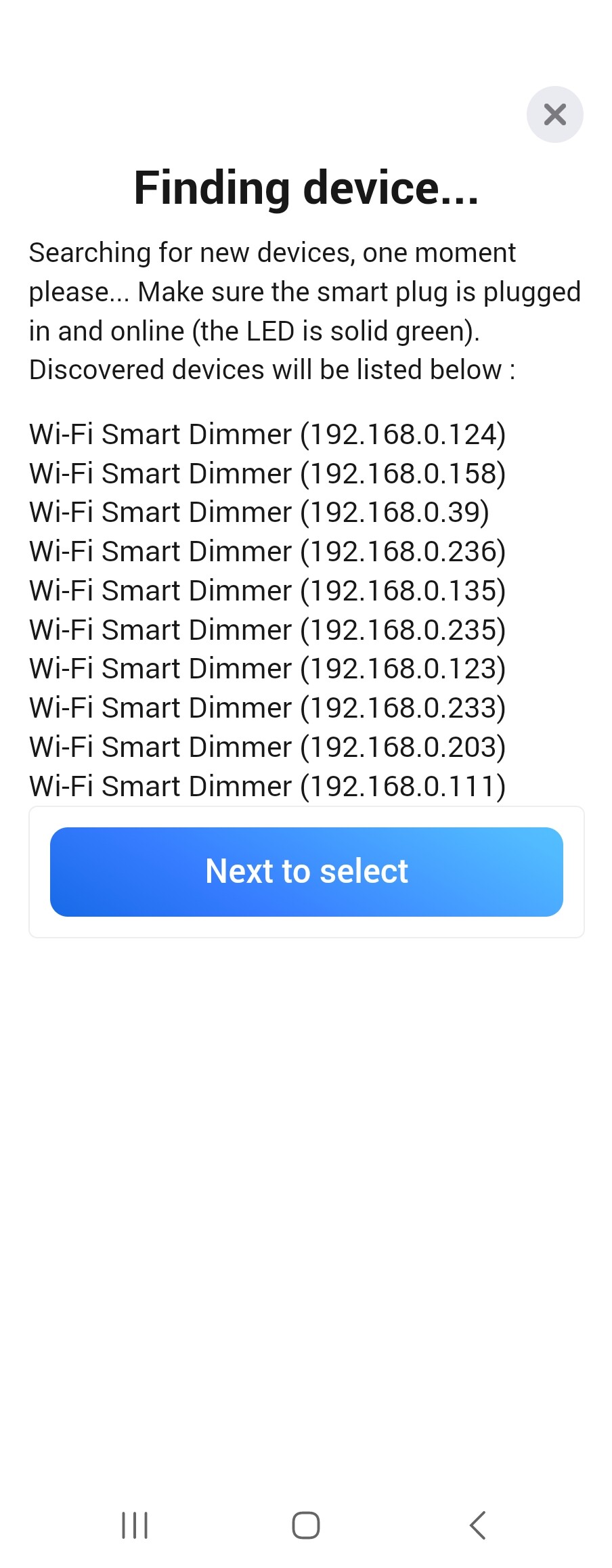

I have about 100 switches between hs100 200 and 230. All show the same as attached just “smart wifi light switch”
Let me know your help is appreciated as it would be alot of manual entry lol.
Can you add one or two and send me diag. report RIGHT after ? I will have a look. Maybe you see just part of the name…

Same thing I deleted and re installed and during the process I attached below what I see and so thr most recent log as per your request.
Thanks.
You did not install latest test version I published…
You are on version v0.2.38 but latest / fixed version is v0.2.39, please update and test again.
IT WORKED!!! thank you so much!!!
