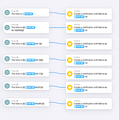

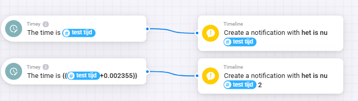

hi @kjeet90 , it seems I am having a bit of an issue with timey not triggering on a time in the when cards.
the top one is triggering, the bottom is not (test time was set to 12), so it seems whole numbers are oke, long decimals are not:
time 13 triggers (only the first one), time 13.1 does not work at all. so seems decimals are no longer functioning…. adding any decimal (.1, .11 etc) none work…

no BLL used here. just normal tags and text…its getting stranger. the first and the last work:
Ill do the BLL route and see if that helps

just tried this, with time at 13.8. none triggered from 13:48:

oke. so tried everything….
13.9 did not trigger anything
14 did not tigger anything either
the more i try, the less works :rofl:

in the and cards it is working:
No BLL quotes needed…
And now it is triggering:
Seems like testing everything, there is one version that does not work, and then all fail :wink:
strangely enough #16 does not trigger
#12 and #13 also trigger, #15 does not

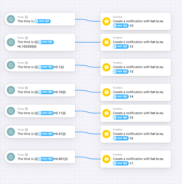

Oke, did one last test, to provide some more info. for now Ill try to see how I need to adapt the flows to make them work. if you ever get around to it, let me know if you need help to test/provide input):
10, 12, 13, 17, 18 fire.
15, 16 do not
the and card does function correctly (when manually testing, before the stated time it gives the no flow, after that it gives the yes flow). So the calculations do work, but not consistently.
Too many When statements in a very short time?
Please try 15 and 16 separately.
tried 15 only, and removed all others, still not firing. really strange
I published a test version now, see if that works for 15 and 16
