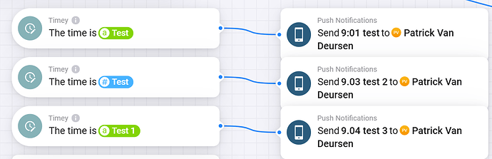

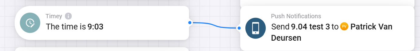

So, the and card clearly works if I use the test from here feature in the advanced flows. I seems as though this does not trigger in the flows themselves? The when card clearly does not seem to trigger. I am using a number variable and not a text variable. not sure if that should be an issue though.
None of these trigger unfortunately:
and neither does this:
Yepp, I think I know what’s wrong. I won’t be able to fix until later today though :confused:
@Patrick_Van_Deursen Test version v1.1.1 out now which should hopefully resolve all your issues :crossed_fingers:
Works like a charm!
