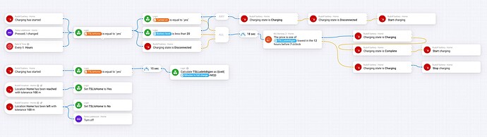

I’m not home so I can’t plug in the car. :blush: Trying to get the flow done.
So then to know how much more I need to charge at home to get to full charge I need to save this when I start charging so when I check on an hourly basis if I should charge or not (based on the electricity prices) I have it stored from earlier.
Do you need to know the already charged amount?
Or only the gap from current SoC to the limit?
What’s your goal?
I need to know “at the current location with the charger I’m connected to now, how long will it take to reach my limit”? Which minutes till full charge gives me once I’ve started charging.
But if I then stop charging because, for instance, this hour is very expensive, but there are much cheaper hours before I need to get moving again tomorrow morning, then apparently minutes till full charge gets set to 0, so I need to store that value in a variable of my own so I know how many hours left of charging I have left to reach my limit. :blush:
Stored it in my own variable here now after doing a ceil(minutes till full charge / 60)
So you need to know the remaining time to the limit. But you know the estmated kW charge rate (11kW at the wallbox)?
Then you can also use ( limit %- SoC %) / 100% * 58kWh * 11kW * 60
58kWh = battery capacity
11kW = charge rate
result should be minutes if I didn’t make a mistake.
You could calculate this on every SoC changed trigger and you know the minutes (and kWh if you remove the 11kW*60) to the limit.
If the API provides the battery capacity (don’t know) the app could calculate this, too. I can check if this would be possible.
PS: The minutes till full will be cleared without active charging becaus in this case the charte rate is unknown. You have to assume a standard value (11kW)
That can vary a little bit based on the current, battery temperature, etc, so I’d prefer to get the actual value from a fairly recent charge at home. But I’m good with what I ended up doing. :blush:
