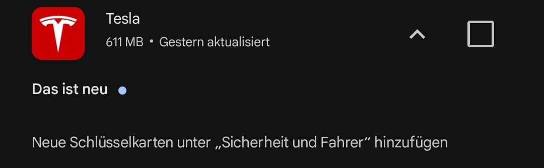

I got an update yesterday on Android. Based on the change log (add key cards), it could be the needed change für lease driver.
