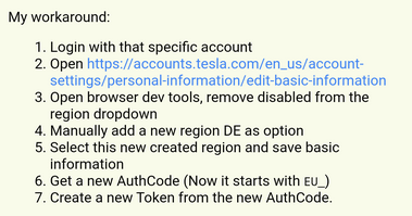

I have a good and a bad answer for you :upside_down_face:
Good:
It’s a known bug on Tesla side. Tesla uses region based service URLs. So I think in your case, your account is registered in EU. But the owner account seems to be registered somewhere else (US?).
In this case, the app tries to request the wrong server.
Bad:
There is no real fix for it. Another developer got it working with a region change in his Tesla account. But you have to tinker with hidden fields and Browser developer tools:
grafik
Are you able to try the fix in your browser?
PS: It seems you also have to change language in addition to country.
I haven’t done this by myself, so this is only forwarding the information.

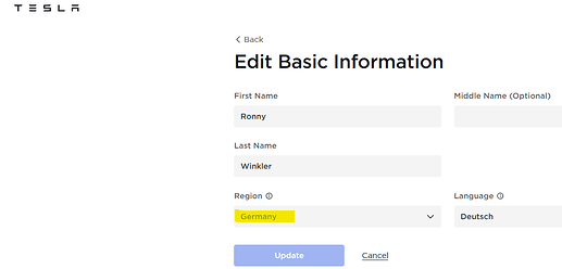

Here is a step by step example.
Open this page in your browser.
https://accounts.tesla.com/en_us/account-settings/personal-information
If it’s showing a 404 error, just click on the icon in top right corner and open account settings.
grafik
grafik
Then edit:
I think this is nor matching the owner region.
Hit STRG+Shift+K
Open the tree:
Right click. Then select “copy”. Then select “insert” and “after”
grafik
Double click on the values and change them to your needs (I don’t know the correct country code:-))
Delete the disabled="" part, too
grafik
Make both for Country and Language.
Then select the new added value.
Then store the settings.
But: You need to know the correct region/country of the owner/leasing company…
And I can understand if you don’t want to do such experiments :smile:
