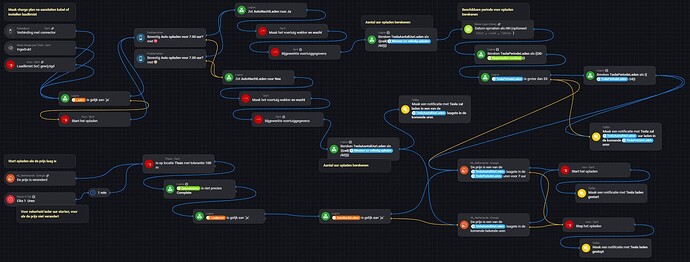

Thank you for this great app! For your inspiration I share the flow I build for charging the car with the lowest utility prices. This flow also uses the Shell Recharge app (of my charging station), Better Logic Library for some calculations and Power by the Hour to determine the hours to charge the car.
This flow sends a push notification to the Homey users to ask if the car should be charged before 7.00 in the morning, after connecting the charging cable or changing the charging limit of the car. Secondly, this flow checks every hour (when utility prices change) whether the charging charging should be started or stopped.
Hopefully this is of some use to you: happy programming :smiley:

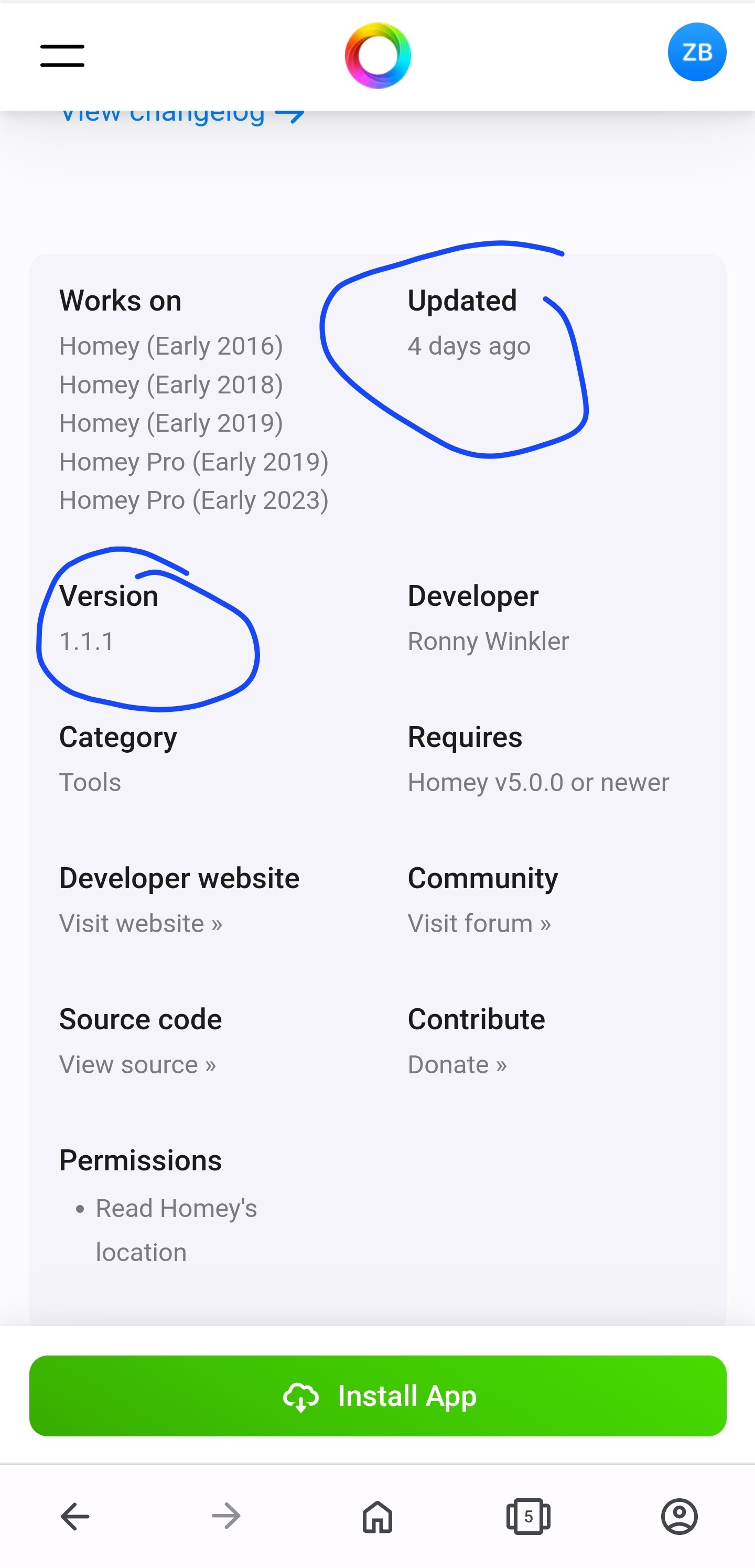

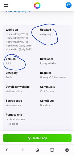

Hello! Thank you for great app :+1:
Can you please advise me how to upgrade to 1.1.5.
I’m still on version 1.1.1 and no higher version is offered. :disappointed_relieved:
Version 1.1.1 is the current live version.
Newer versions are test versions (until I release id to review and it’s approved by Athom).
If you want to try test versions, you can use the URL with /test at the end:
https://homey.app/a/com.tesla.car/test/
Or open the change log in app store and click the “test”:
My update information is about new test versions for users using the beta to know what’s new or what has changed.
If you are on the live version, you get auto update if a new version is approved as live version.
If you are on a test version, you get auto update for every new test version.
So if you have no issues with reported bugs that are perhaps corrected in a test version, you can sty on the live version, too.

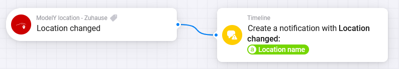

Hi Ronny!
Found the problem, it was on my side of the keyboard! :crazy_face: Sorry
In my flows, after the ‘when cards’, I was updating a variable called ‘Tesla is home’ in logic. But the variable is only located in BLL :cry:
These flows, when triggered, stopped and I never got any entry in the log or on the timeline.
All is well, thanks for all your help!
/Johan
hehe, I was already testing and debugging and could not find an issue :smile:
Happy to hear that all is ok now.
You can perhaps remove your coordinates from your old post.
