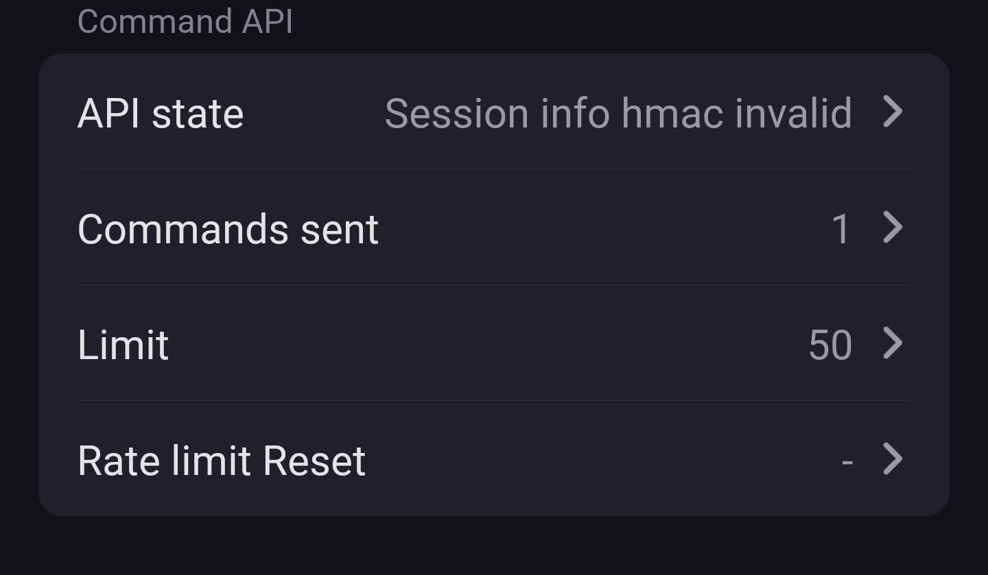

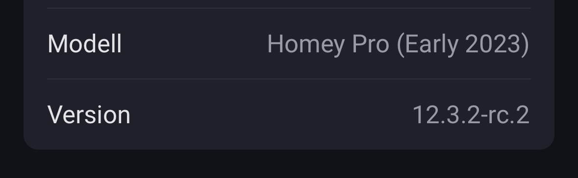

I still have the same issue. I have restarted and repaired a couple of times on v 2.0.4, with the same result.
I have same problem. Data readings is OK. But all commands fails :cold_sweat:

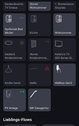

Hello Ronny
I was able to transfer my existing vehicle to the new app without any problems (try repair).
But now I have the problem that I have to do this repair every morning.
Is this a known problem?
I have HP23
Tesla App Version 2.0.4
