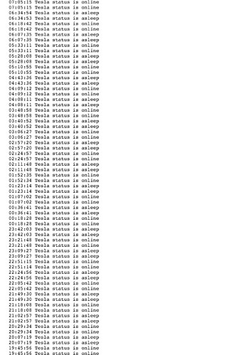

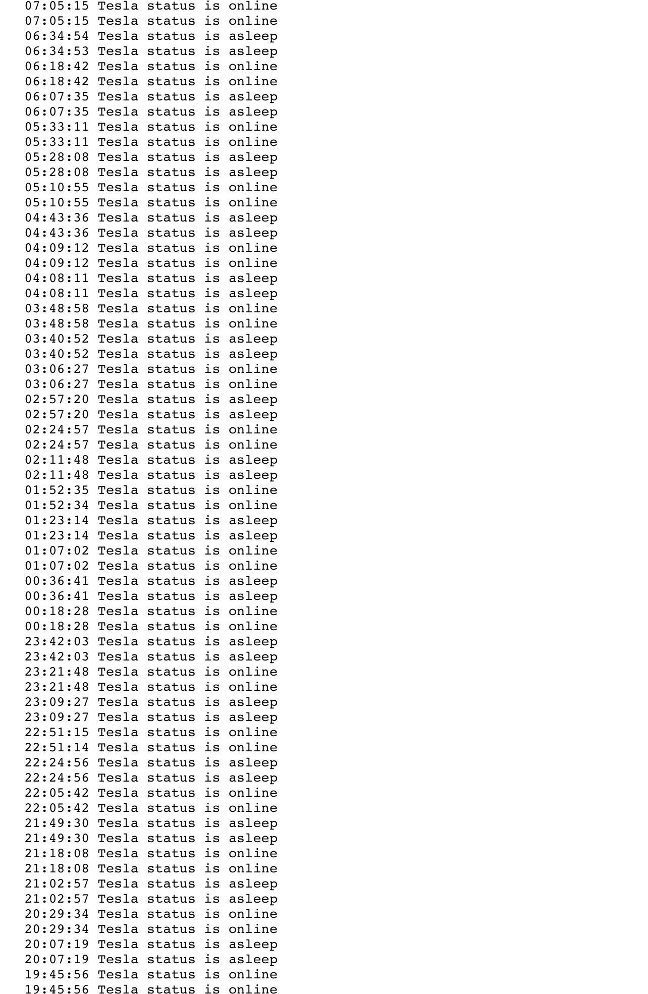

@balmli Great app, thanks for this! It works fine now with MFA now by the way. I installed it yesterday, v1.1.3 from the Homey store. I have created 3 flows, checking if the car entered the garage, is there is a software update and if the car status changed. The flows just log something for now. Data fetch interval is set to 240 minutes.
This morning I checked the log and it seems that the ā€œstatus changedā€ command runs twice and a lot more than I would have thought, given the data fetch interval. I am afraid this does not leave the car much time to enter ā€œdeep sleepā€. Could you please look into this? See screenshot of the log below.
My interpretation was that the app would not wake up the car for queries (in between the fetch interval), it only will try to when you send a command.
Thanks in advance for your help!
