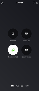

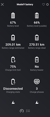

Here is a short preview of the new app:
Edit: We have enough testers now.
I can invite upto 5 beta testers in the Homey Slack channel. If you can spare some time and want to test and help with reporting issues and feedback, you can answer here and post your Slack user. The first 5 posts win :slight_smile:
