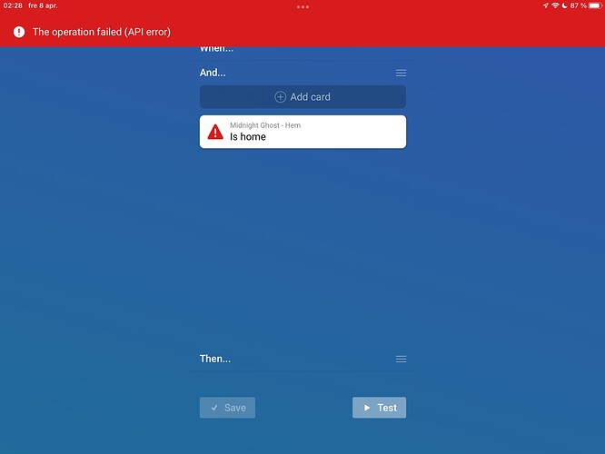

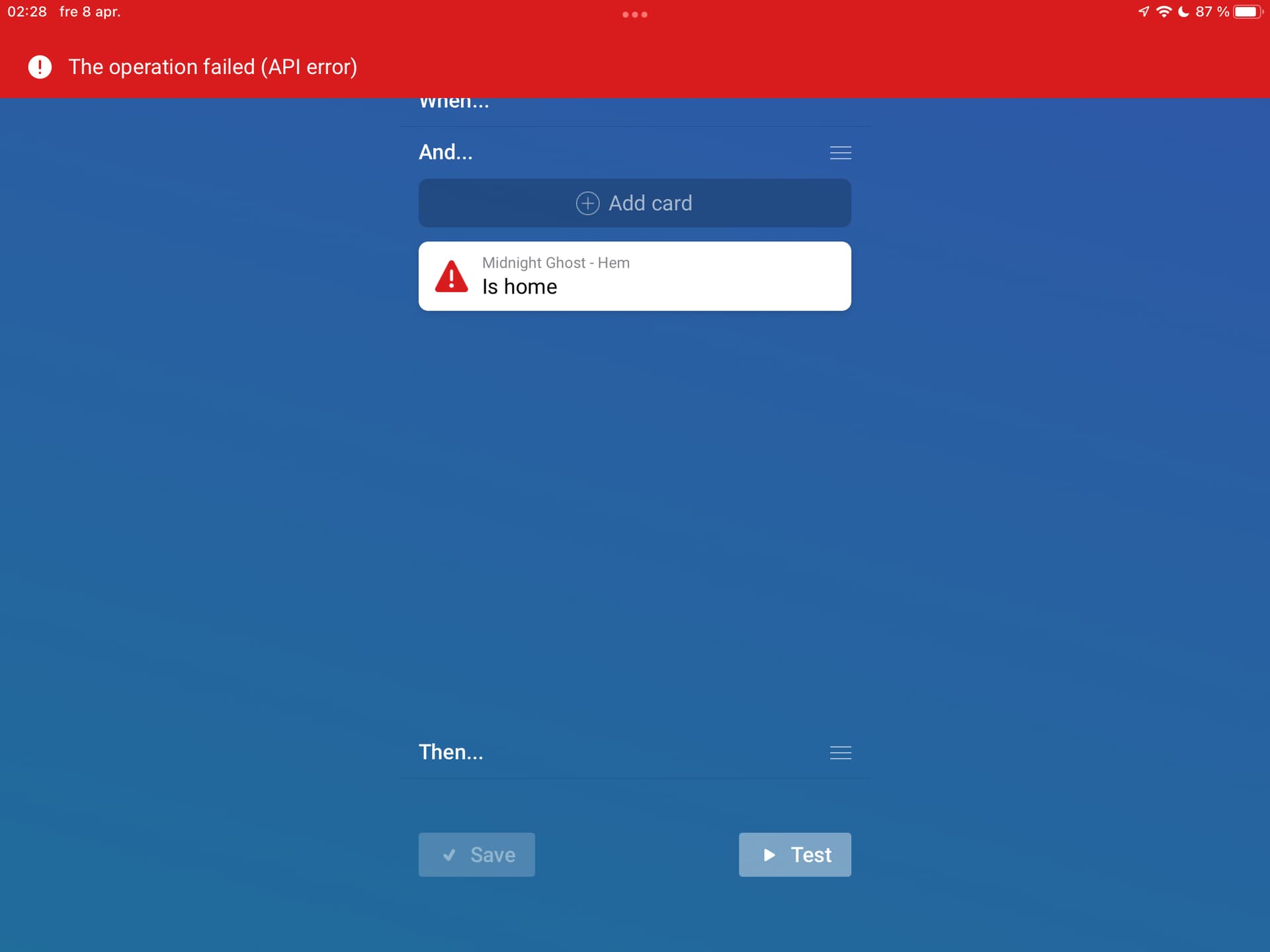

Trying to use the card: "Add current location to geofence as: … " seems to fail with an API error.
Try to repair the conection.

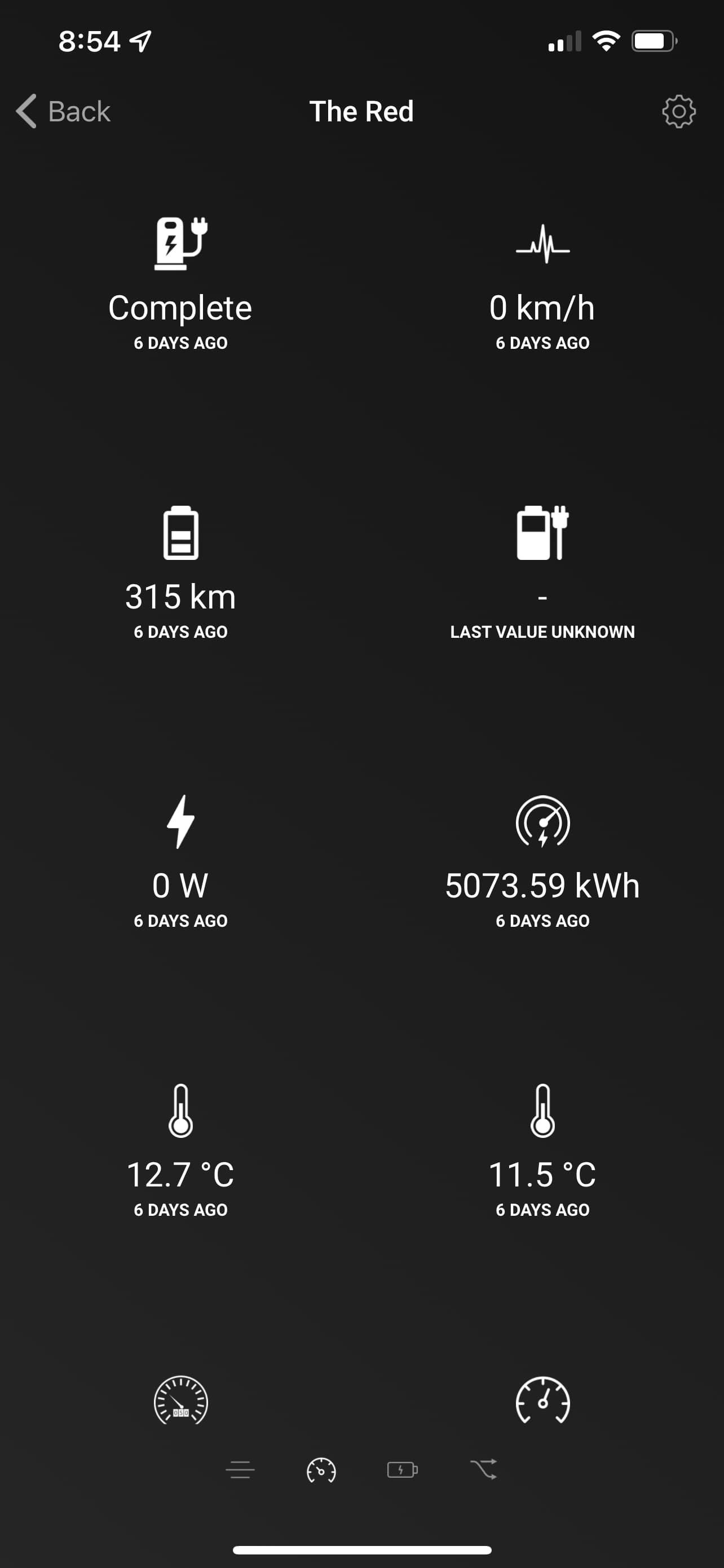

Since six days the app is not getting connected to the car. I tried repairing several times, refreshed the token from the Auth for Tesla but this isn’t helping. I’m not sure what else I could do. Can someone help please?
The car version software is 2022.4.5
The homey Tesla smart charger version is 1.5.4
Restarting the app did the trick!
This was resolved when Homey updated to 7.3.0.
